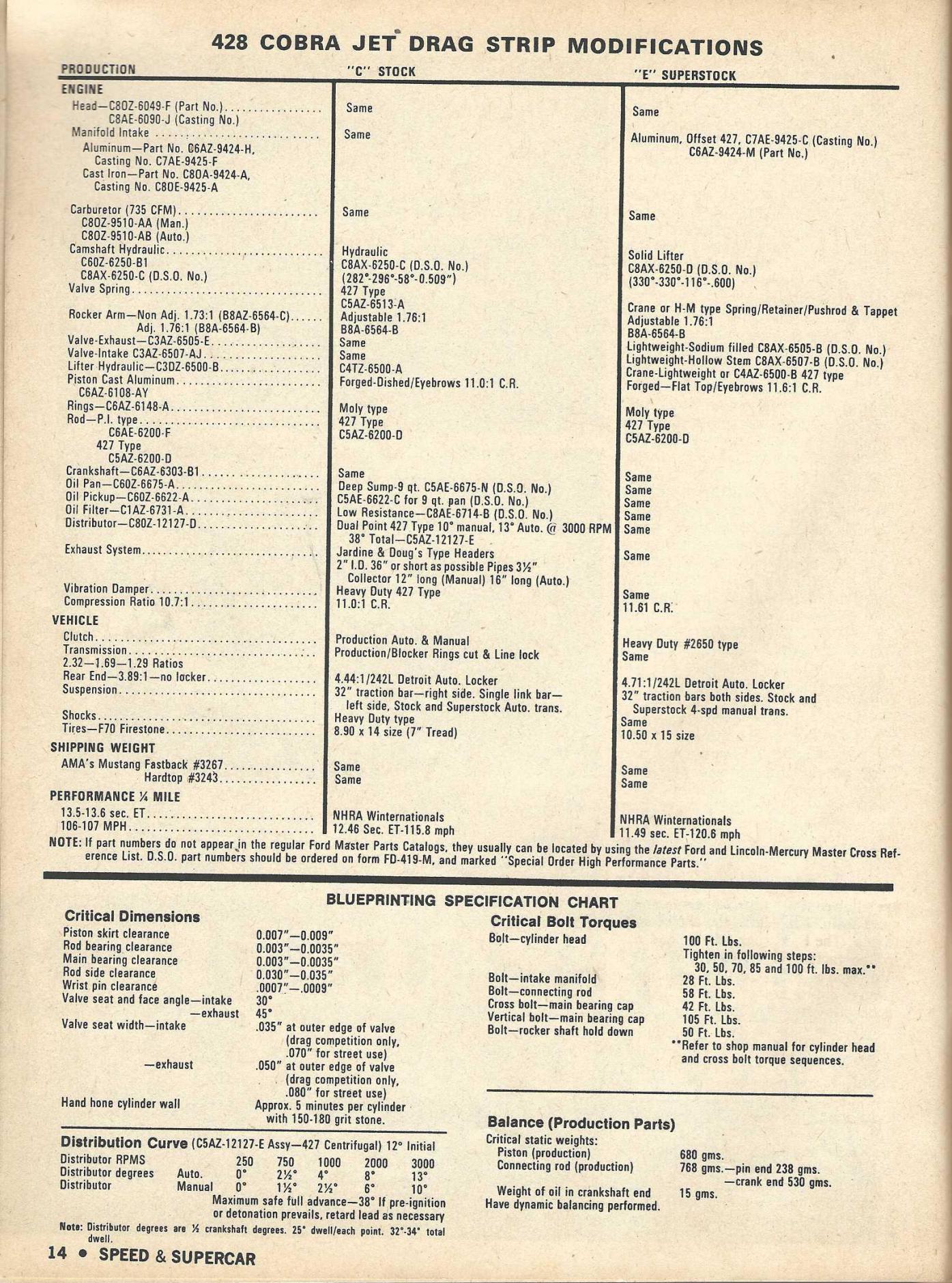

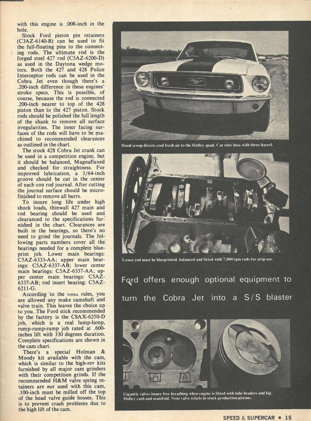

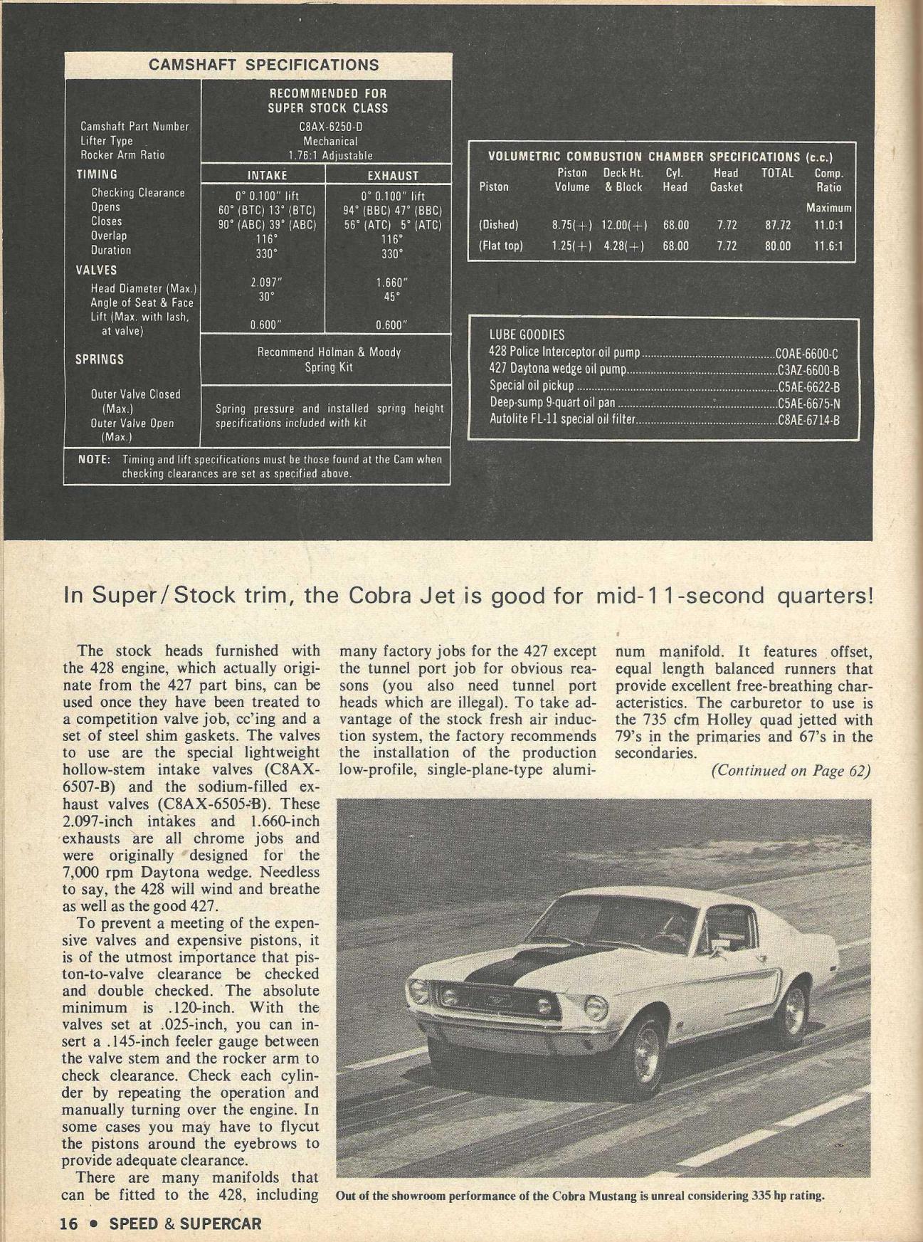

Getting the most out of the newly introduced 428 CJ like Joniec & Platt have at 68 Winternats!...
www.vintagecertification.com
