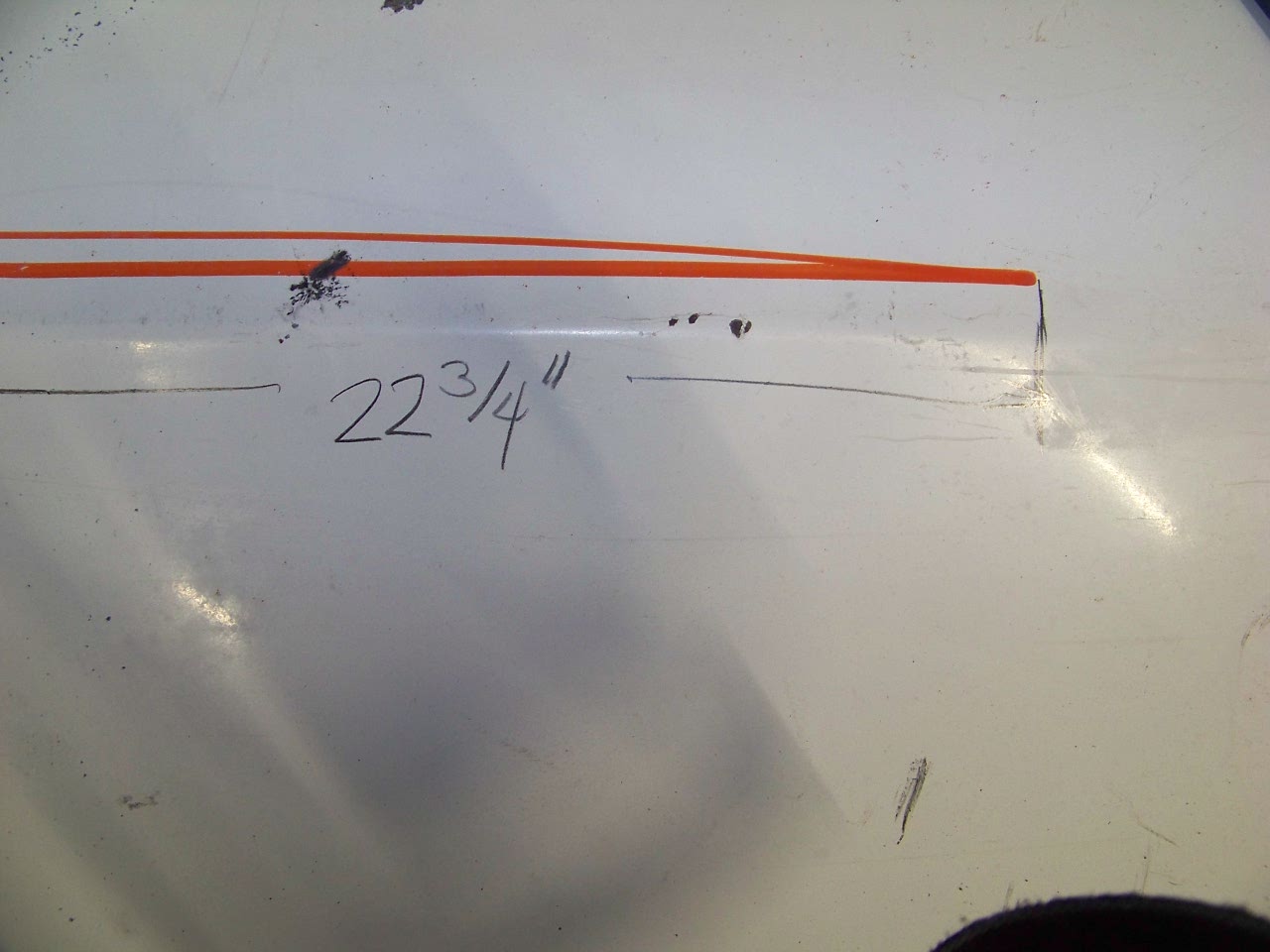

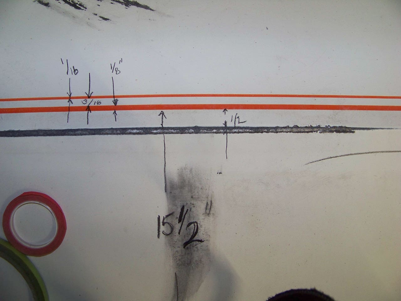

on a 69 Camaro the side pin stripes where they 1/4 or 1/8 inch wide

These measurements were taken from an 03E pace car door.
15-1/2 from the bottom of the door and 22-3/4 from the front of the door.
