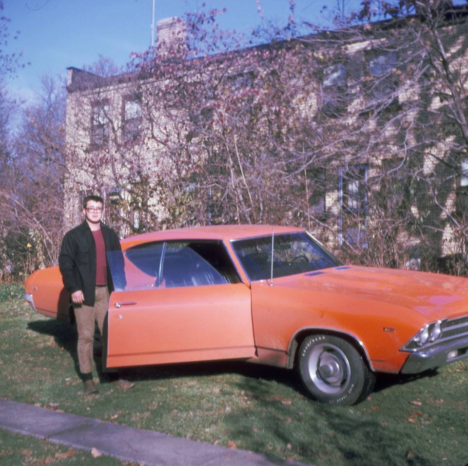

Hello Folks-
Question for the experts here. For a 69 COPO Chevelle (427 car, but NOT Yenko) what wheels would it come with?
XT type? Rally? I have seen with SS wheels which made me scratch my head, but the owner is VERY knowledgeable and a member here.
Anybody have any insight?

----All the Chevelle COPO's I have seen paper for had SS wheels.....Bill S

All COPO cars carry one of the option codes below:
9562AA: Four-speed transmission and positraction 9562BA: M40 three-speed automatic transmission and positraction 9562cd: Four-speed manual, special contour bucket seats, COPO tires and special-order springs 9562ce: Same as above, excludes bucket seats 9562dd: M40 automatic, bucket seats, COPO tires and special springs 9562de: Same as above, minus bucket seats 9562ea: Four-speed manual transmission, positraction, J52 disc brakes and L78 tires 9562fa: Same as above, except M40 automatic replaced four-speed 9566aa: Same as 9562EA with the exception of tires (used RPO PL5 14s) 9566ba: Same as 9562FA with the exception of tires (used RPO Pl5 14s) 9694ca: Four-speed together with 9562, 9737 and RPO J50 vacuum power brakes (This option modified RPO J52 power brakes) 9694cb: Three-speed automatic transmission together with 9562DD, 9737LD and RPO J50 vacuum power brakes (This option modified RPO J52 power disc brakes) 9737ld: Sports car Conversion/ Yenko/ This option was 15-inch tires and Rally wheels
https://www.hemmings.com/stories/art...-copo-chevelle

AFAIK, the 15" Goodyear Wide Tread GT F70x15 were only used on the 9737LD COPO Chevelle.

This is a period correct photo.
