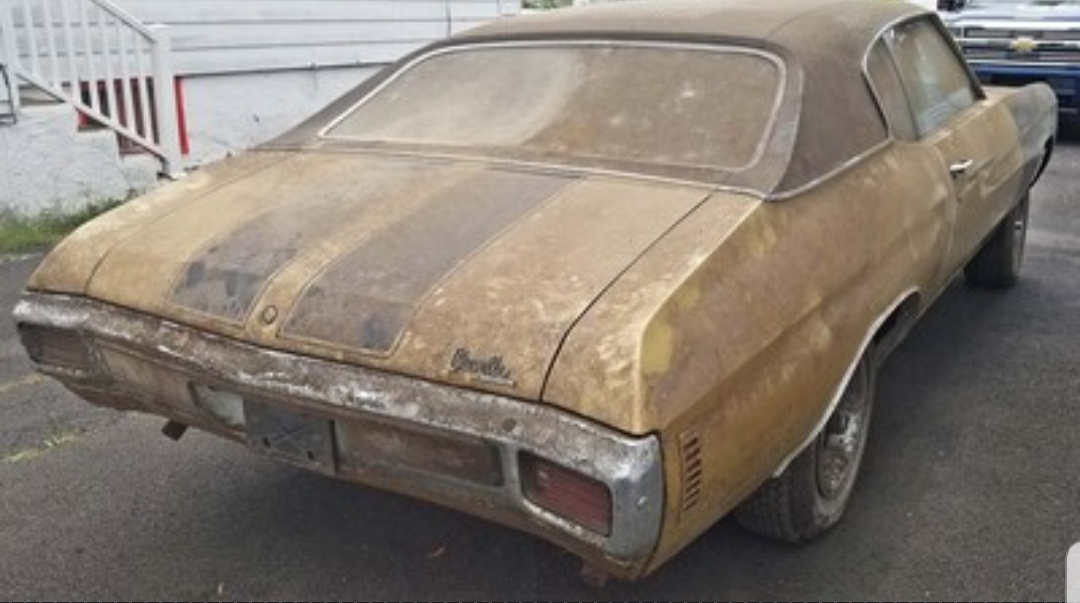

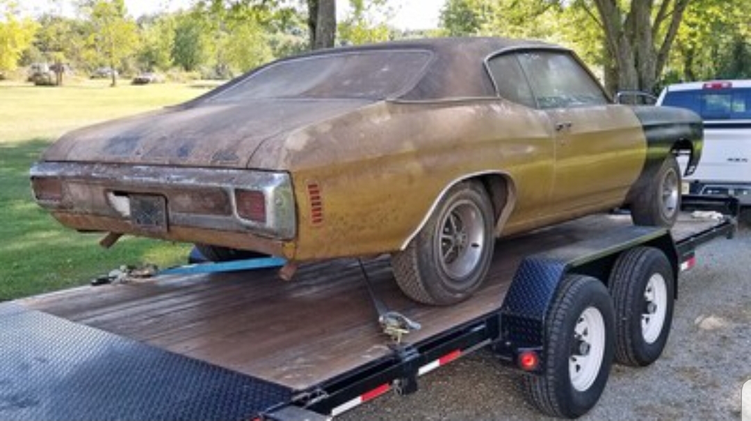

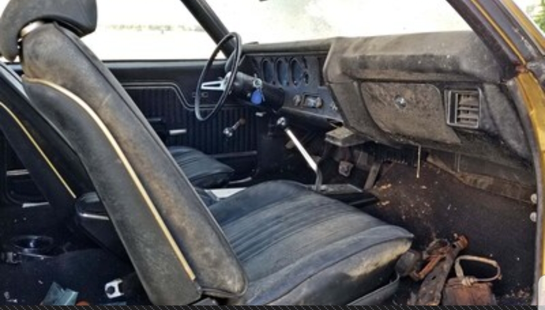

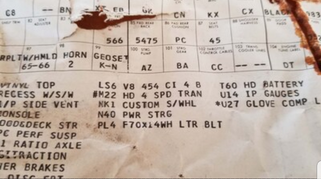

Another great LS6 rescued. I had heard of this LS6 find months ago, it was rescued and resurrected. Love the domed hood with factory applied stripes. Nicely opted and very unmolested and complete. Great to see it being cared for and driven! A few members were involved in this discovery.
https://www.motortrend.com/features/...ls6-barn-find/
Before pics:

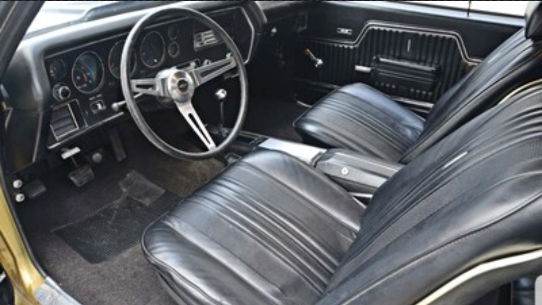

Resurrected, cleaned up and ready for the road!!!.

Cool find, I can almost smell that interior in the before pics.

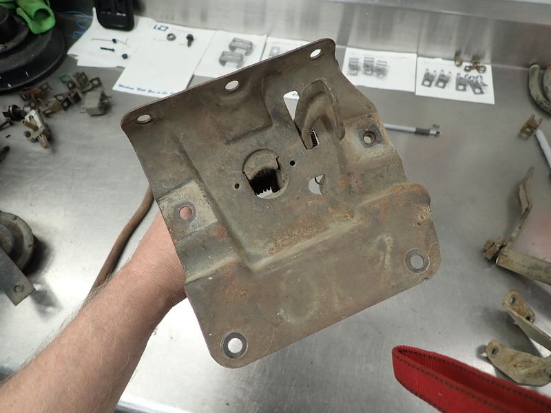

That is in fact the last three numbers of the job sequence number that is found in box 1 of the buildsheet. These are commonly found on Baltimore Chevelles and more rarely on some other plant cars. I find these on the bottom of the hood, hood latch, snorkel tube, door jamb, top of the heater box and top of the fuel tank to name a few.
The first 2 photos are of Oliver Pask's white LS6 I am currently restoring.
The one labeled 504 is of Harry Snow's 8000 mile survivor Baltimore L34. I have several more examples in my data base.
