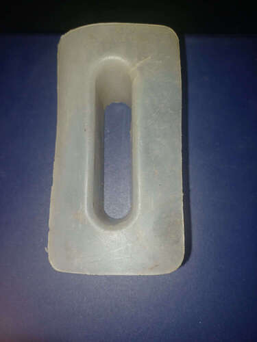

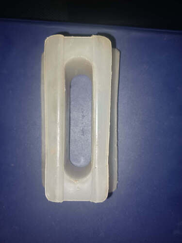

Default benchseat seat belt guides
Here are top and bottom pics.

Thanks - I have those pieces ... need the "tubes" the seat belts go through from the attach point to the buckle ...

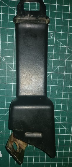

Default bench seat seat belt retractor guide
Got,cha you must be referring to the seat belt retractor cover , the hole assembly has to be replaced because the steele buckle is wider than the opening in the plastic cover unless you remove the buckle and resew it. This is a replacement for my nova in the pic below .

The retractor cover on the 69 Camaro is a little different, but I was able to remove and reinstall it by heating the cover in hot water, making it much more pliable. As I recall, it was still a challenge, but doable.
