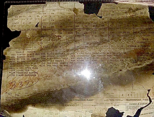

Not a lot of '69 Chevelles out there with a build sheet, window sticker, dealer invoice, etc. Very interesting to see 'Gauges' misspelled on the build sheet....

Is it just me or do the broachmarks look manufactured?

They sure seem heavy. Deep enough to hold paint….curious what others think. Neat car if it all checks out
Thought the picture wasn’t good enough to make a call on the broach marks, but I also found them a little unconventional looking.
Has anyone else seen “gauges” misspelled on a build sheet? |
1969 Framingham build sheets are scarce and if found, most of the time it will only be the left 1/3 of the sheet. U14 will not be on that side, so not many to compare to. The misspelling is definitely suspect as are the broach marks but I can’t say for sure without further investigation.

I found one in the archives, full sheet with U14 option. Same factory error

Where are we looking for the misspelling? I looked at all the info and couldn't see it... Maybe you were thinking gages? |
It’s spelled gauge, not guage.
