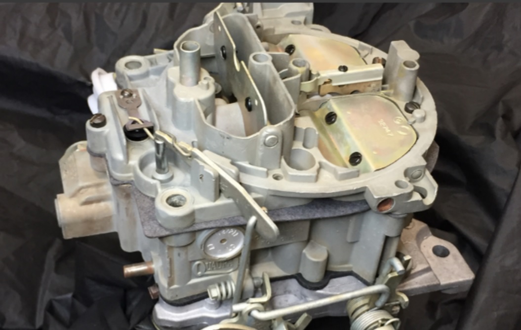

I was overzealous with the gas this morning and flooded the carb. What’s your cold start procedure if the car has been sitting for a few weeks/months?

Thanks! I’ll try 3 or 4 pumps and see how it goes. I’m going to charge the battery first so I’m not thinking about killing it turning the car over. It was close to starting so I kept pumping this morning and it puked some gas onto the manifold likely from the shaft as the inside of the breather was dry. I’m letting it evaporate fully before trying again.

The gas in my Qjet evaporates after a week. I don't touch the accel, crank it until the oil light goes out, try 1 pump, crank it, then 1 pump, then crank, etc. Usually takes 2 to three separate pumps to get the fuel bowl filled and it starts.

His should be a quadrajet, no bowl vent tube.
The carb should have a working choke. Pump the pedal once to set the choke and then crank until it fires. If the gas has bled back to the tank, it can take a while to get it back. If it hasn't fired after 20 seconds, pump it once again then crank.
