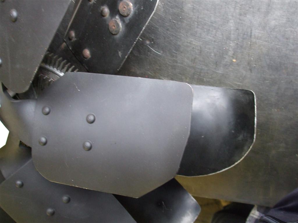

The 772 and 064 fan are very similar to each other, other than the tip design which I believe was done for noise reduction so neither an upgrade or downgrade in my opinion. (Rick Peters photo)
