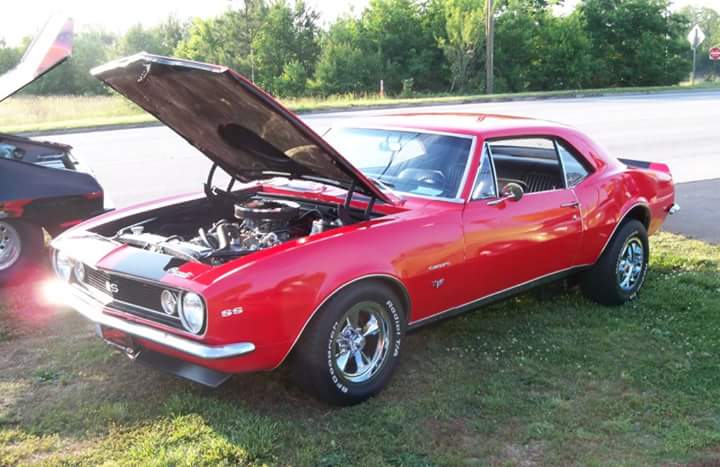

My 20yr old son has a 67 camaro that is all stock and besides new metal, interior and drive train are original. Nothing too special 327/210 hp. He loves the 70s look with the big tires in the back and the crazy paint. O yeah shackle kits also. He is going with 15x6 cragers in the front and 15x8 in the rear. The tires he is thinking of getting are the BFGoodrich radial TAs. 205 60r15 for the front and 255 or 265 60r 15s for the rear. Any feedback on the tire, wheels and stance would be great. And what do you think about turning the white letters in. Thanks, Mark

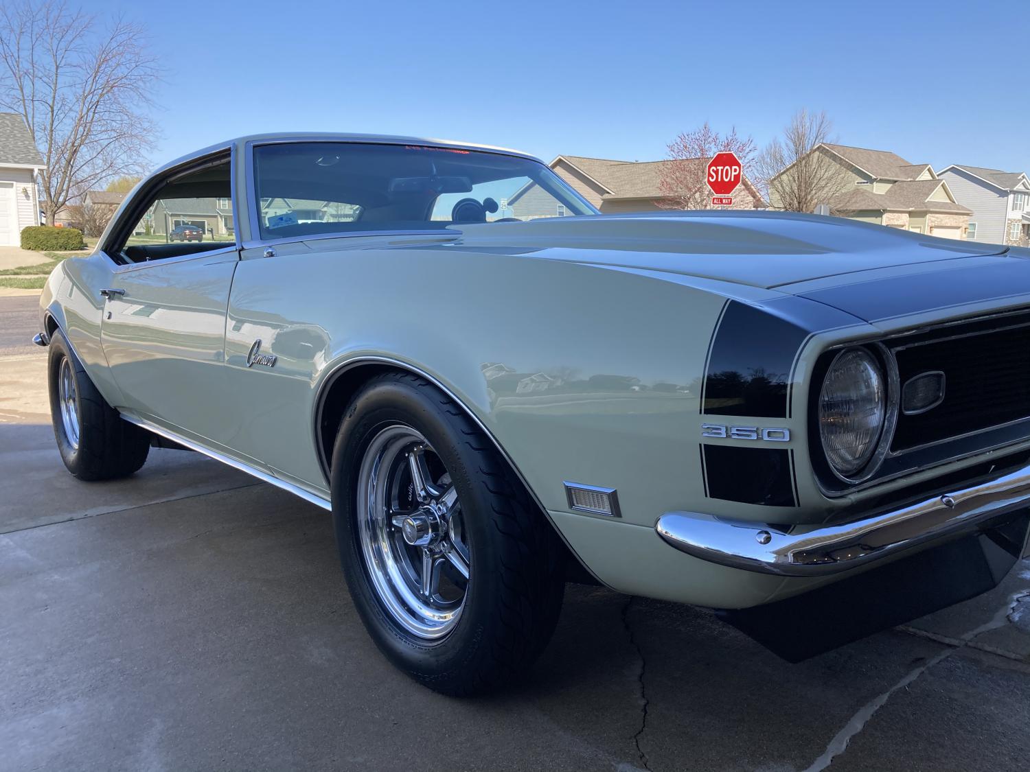

Hi Mark, that's a great tire IMHO. And his plan sounds similar to what I did on my barn find '69 a few years ago...
click here and check out post #16 for pics:
https://www.yenko.net/forum/showthre...rn+find&page=2
I put the stock 14X7 XT wheels on the front with 225/70R14 BFG Radial T/As and used the as-raced 15X10 rims on the back with 295/50R15 - worked and looked great, again, IMHO. All with the RWL turned inward.
Have fun with it!

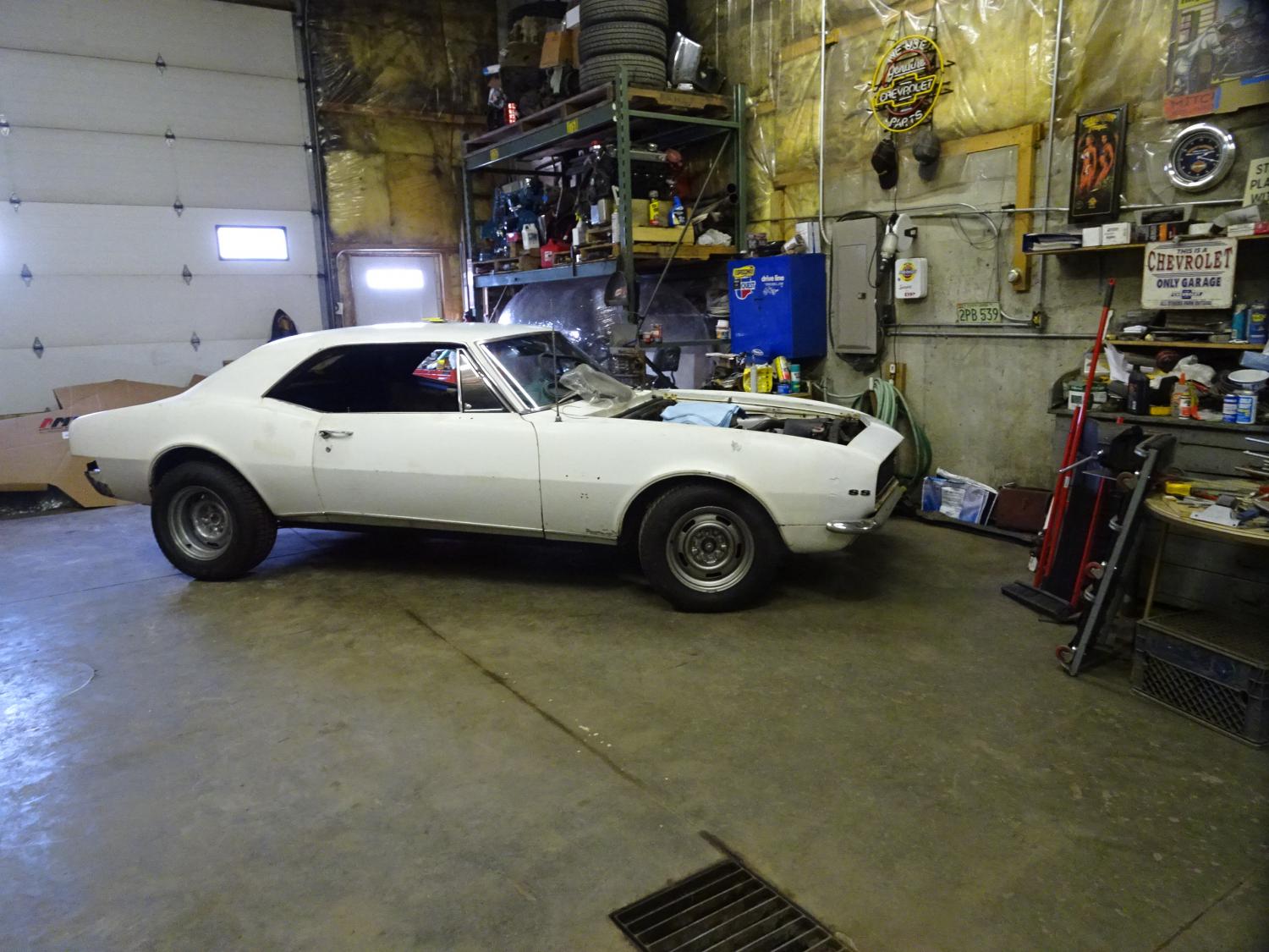

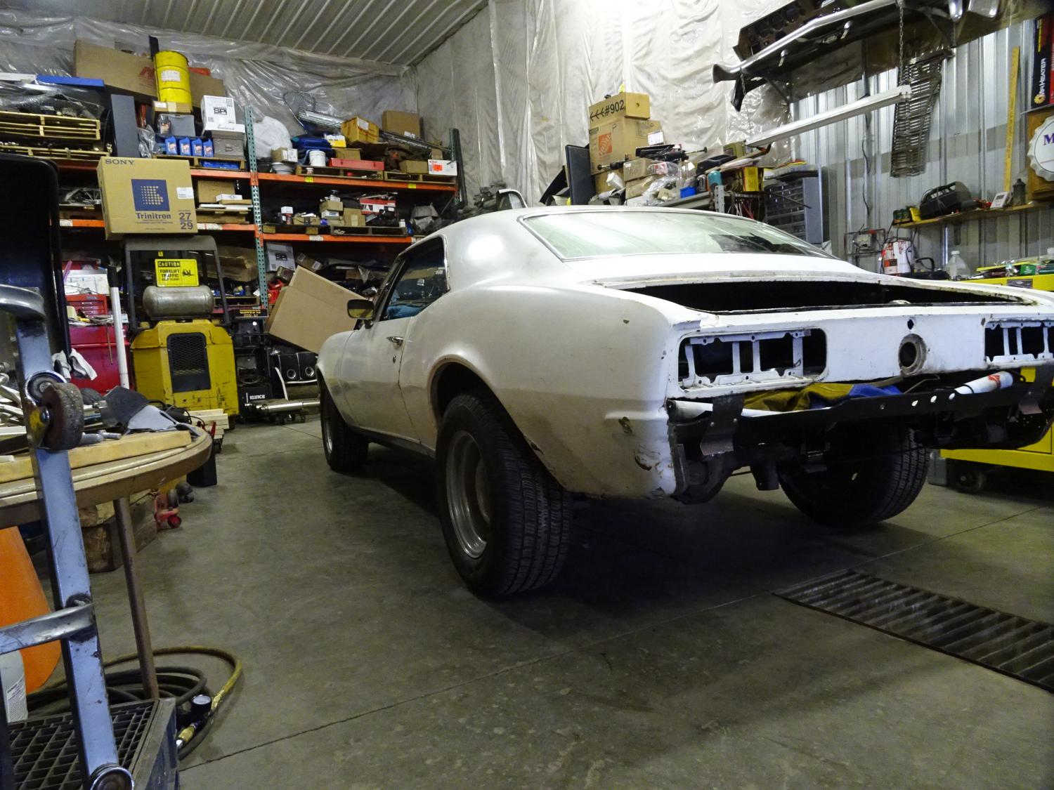

I have reproduction Corvette style rally's on my '67 Camaro. 15x6 front, 15x7 rear, with 215/65 front, 255/60 rear. They fit and fill the wheel opening nicely. The rears will rub the inside on a steep upgrade into a driveway, if I go in an an angle. Straight on and no issue.
If he is going black wall out, there are many tires with better traction ability than T/A's. I wish Rusted Tires had a better website with pics of the reproduction radials now available. I, and buddies, have had handling and traction issues with the T/A's and don't buy them, but that's just my experience.
I was able to attach a couple pics directly from the hard drive. Not sure why the back appears so high. I was moving it around with a floor jack and it maybe hadn't settled yet ?
Mitch

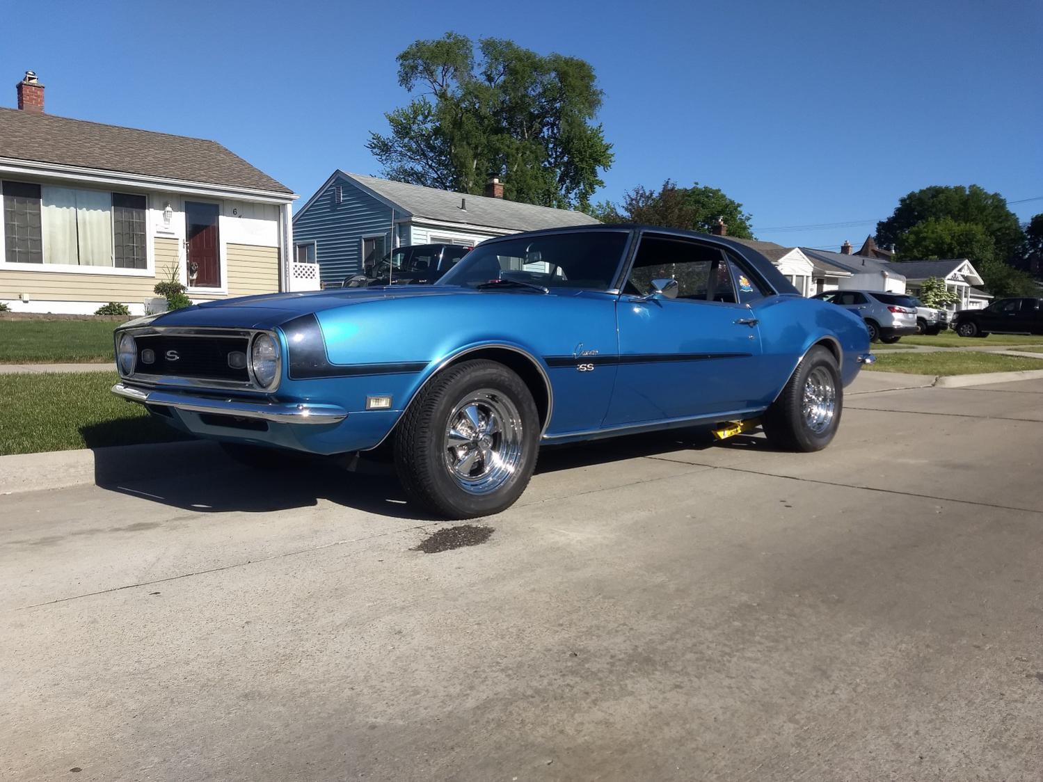

Here's my old 68 with 215/60 fronts and 225/60 rears using 15" x 7" rims both front and rear. Car was setup with multi-leaf rear springs and z/28 coil springs up front. Many a people commented on it having a great stance. Hope it helps.
