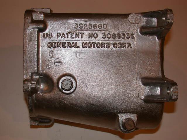

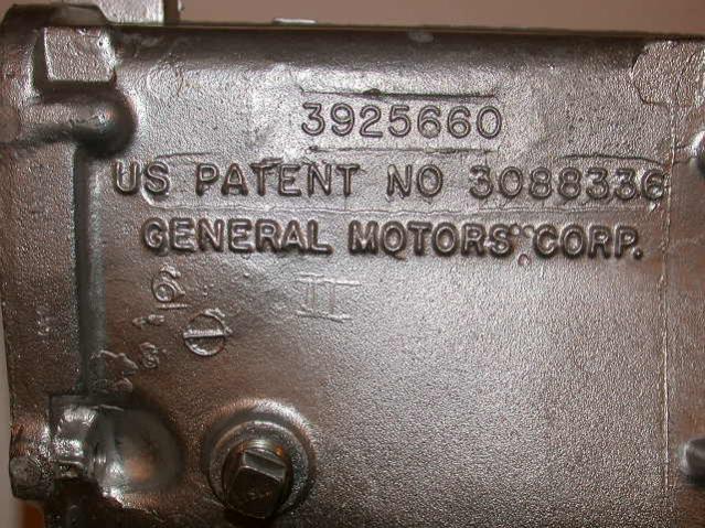

Here is a picture of an NOS Muncie case that has the CC0 and a serial number. It has no assembly date as it was an over the counter replacement case.
