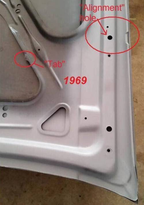

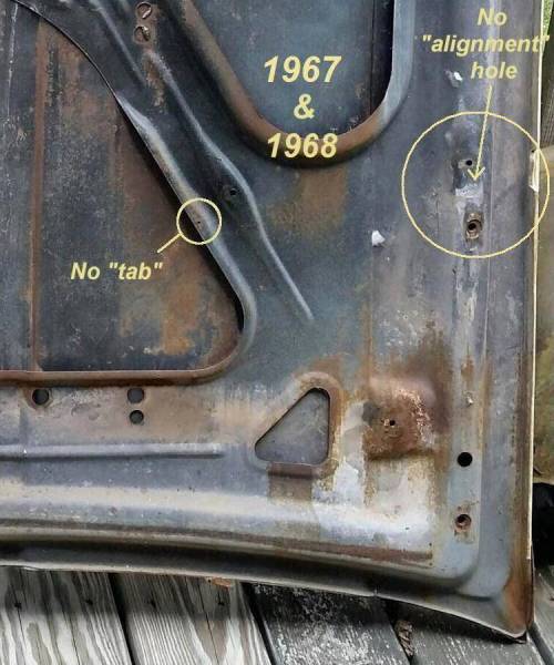

My z28 currently has a cowl hood that was put on it very early in its life .
It was originally a flat hood car so I am going back to that.
I have never owned a flat hood first gen Camaro, so I am not aware of the difference in identifying a 69 hood. (if there is any difference)
I found a hood within driving distance. Its supposedly off a 69.
Any way to tell??
Attachments - The Supercar Registry flat hood 69.jpg 69 Hood (underside).jpg 67-68 Hood (underside).jpg

That appears to be a 67/8 hood.
Any way to tell??
Yes. There are a few differences. Here's a couple ref pics I saved.
-Dave
Semper Fi!
69 Camaro SS396 L34 X66

Thanks for the link. I would agree its a 67-68 hood. That figures!!
Now I know what I am looking for anyway.
Just gotta try to find one close.
Thank again guys!!1 I really do appreciate it!!!
