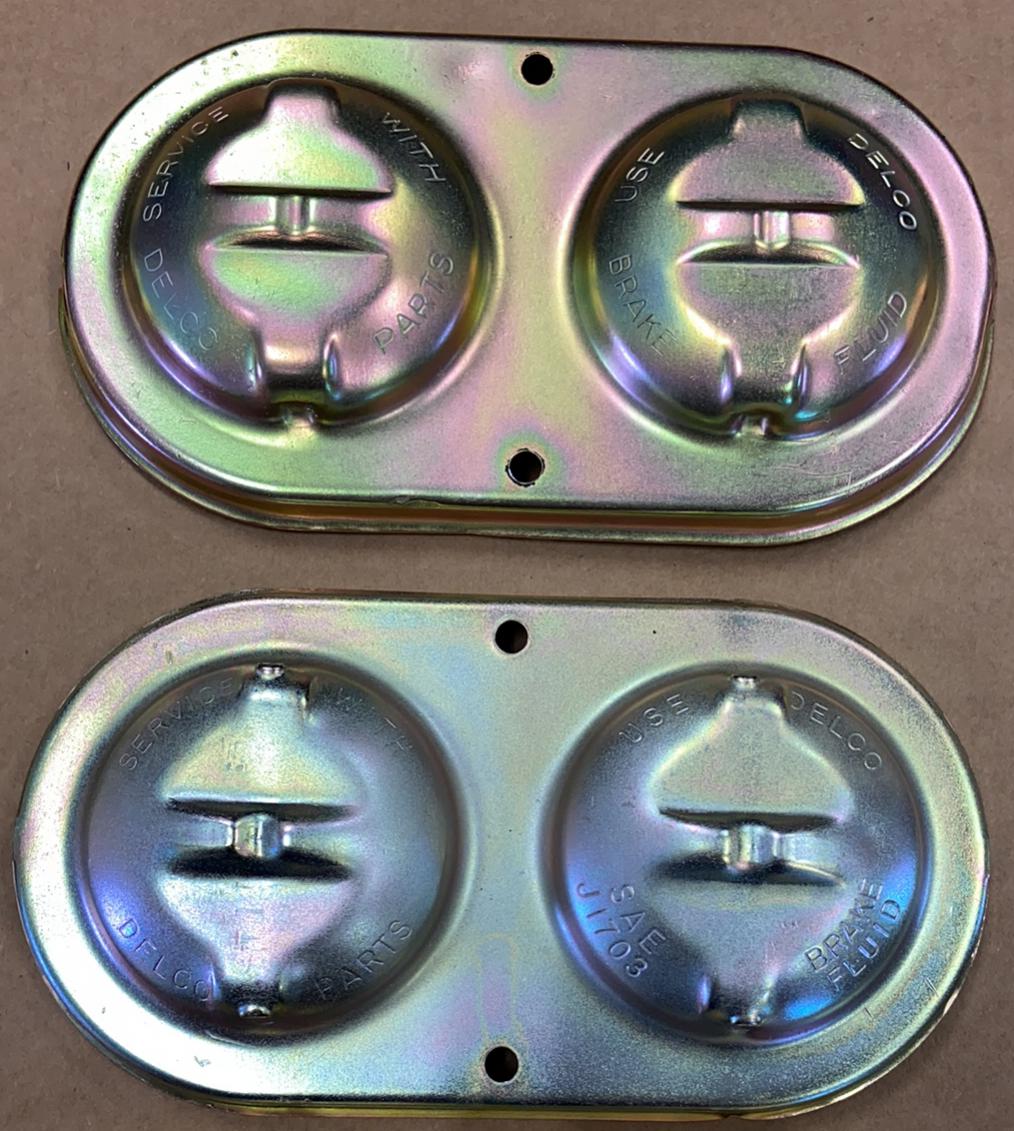

Question 1969 Camaro Master Cylinder Cap Have A J1703 Stamp Always ?
For the 1969 Camaro experts which I am not, I am stumped why one of these caps have a J1703 Stamp but the other does not. Is it a date code variant were one came without J1703 Early and other later with the number.
Please let me know. Thanks.

This might be helpful...Joe
http://www.camaros.org/forum/index.p...ic=12201.0;all

Very Helpfull, thanks for that Joe, so from what I read early No J1703 then mid 69' J1703 stamp added.

If it helps.....my 05A built car has the J1703 cap.

Frank what is your vin up to the last 2 or 3 numbers?
ours- N6352XX
I ask because one of our cars has a final build date of April 28th and I'm trying to determine which cap is correct vs another survivor just built a short time before.
