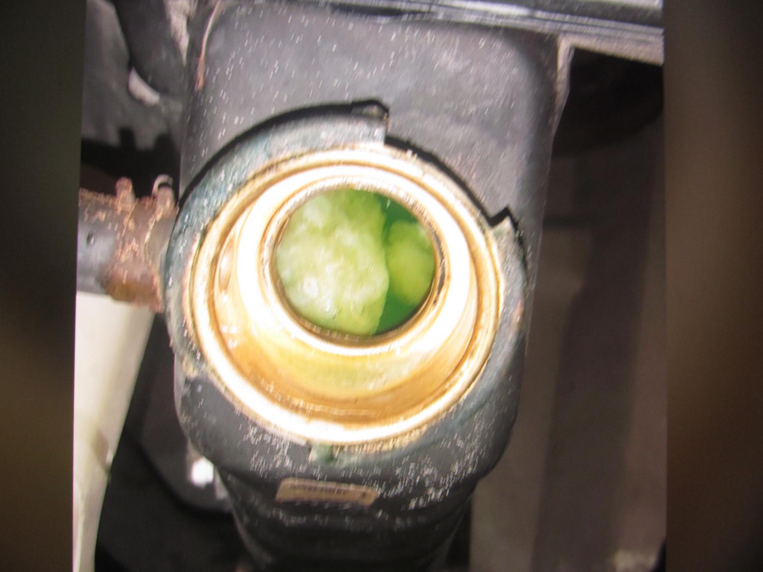

Pic of rad. what is it? !
No Fisher priced toys here

Either coolant gel from contamination, silicate breakdown/drop out, some iron corrosion or aluminum corrosion. Silicate dropout (white gel, goo or chunks) happens when the antifreeze/coolant has been used beyond it life expectancy and the additives break down. Mixing different types of coolants can make some weird gel byproducts too. Or possibly some form of stop leak. Flush it well and use good quality coolant with soft water or filtered water.

If they are solid then a bad case of calcium depositing. This can be chemically flushed. Better put-a lime deposit.

I have seen plain water have soft clumps, but I have never seen antifreeze do that.

Looks like ice? Failed anti-freeze?
