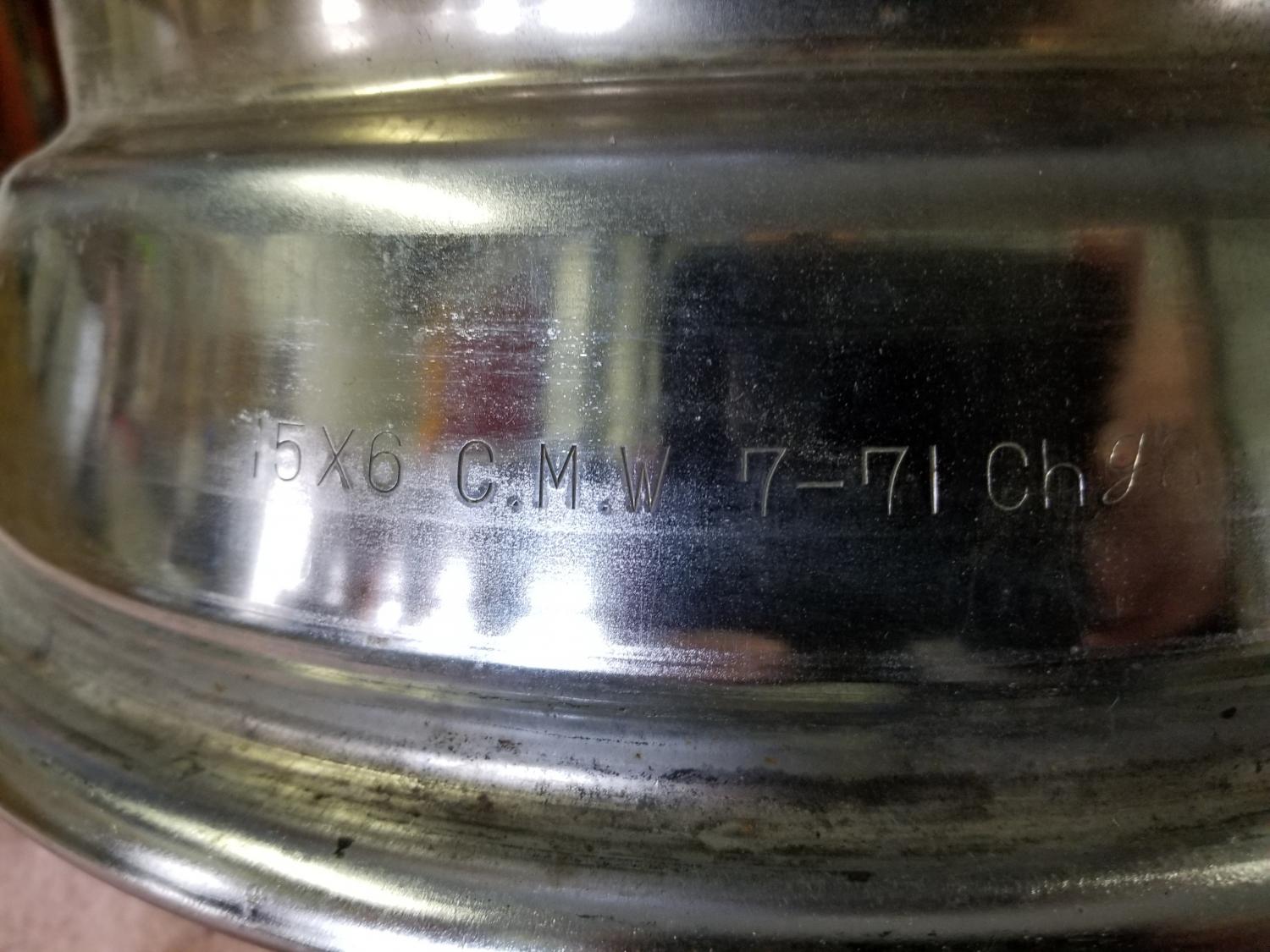

Just picked up a set of SSs like I've never seen before. They are steel hoop with aluminum centers, but, the two pieces are staked together. Any information would be appreciated. Thanks

Cool. I need a set in that size (15x6)
Nice score. How do the fronts look?

Those are older ones, your date code is July of 1971. "C.M.W." Cragar Motor Wheels??
I have a 1971 dated Cragar SS wheel and it looks the same as yours. Must have been how they were put together then...
Very Cool!!
