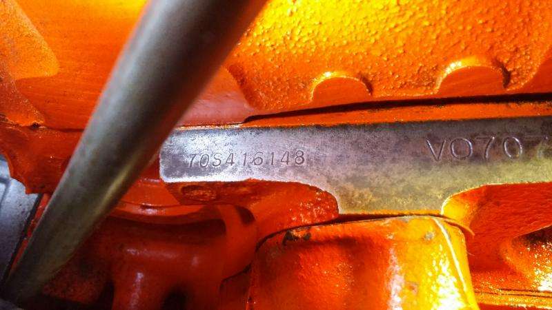

----Yup, Tony, I like this one to. Does it have the eyebrow pinstripes or not, and I do wonder about the pad. Wish the original orderer would have ordered deluxe interior. That would have put it over the top for me!.....Bill S
I wonder about the pad too Bill.
Lawrence
What are you wondering about on the pad?

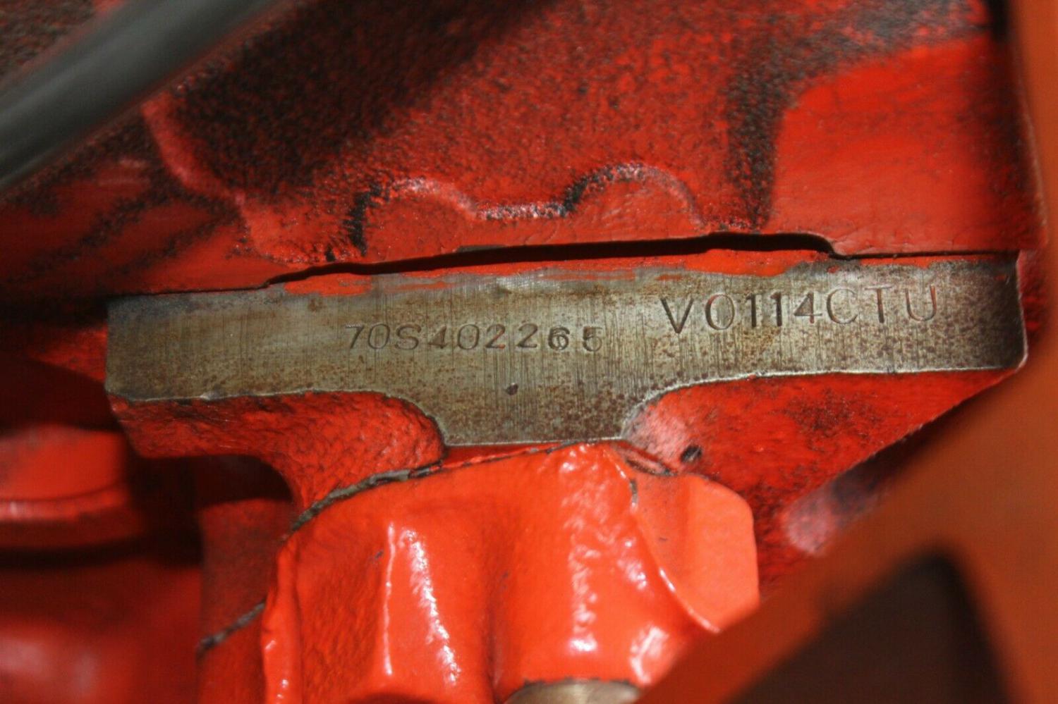

I agree with you Bill. C3 Black leather is really comfortable. My old Lt-1 pad was V0302CTU and looked exactly the same as this one. Pad looks good to me.

FWIW recently a local customer sold his 70 LT1 coupe -donnybrook over tan and LT1 roadster - Laguna over blk std for 70k each inside of 3 weeks - both were over 97% top flight cars.
SO I consider it Strong money for a the above car which needs a good bit of work before being judged.
additionally I have serious questions regarding the pad and stamp.
The linear-ISH lines running front to rear on the pad are not marks made by a broach, they are scratches and were put there by someone free hand.
~JAG~

----The "scratches" aren't parallel. That's what I wonder about. Glad others see it too as I don't want to be the only one dissing a nice looking car!.....Bill S
If you owned it you wouldn't be mentioning it....
Looks great to me, I owned one that looked worse than that
