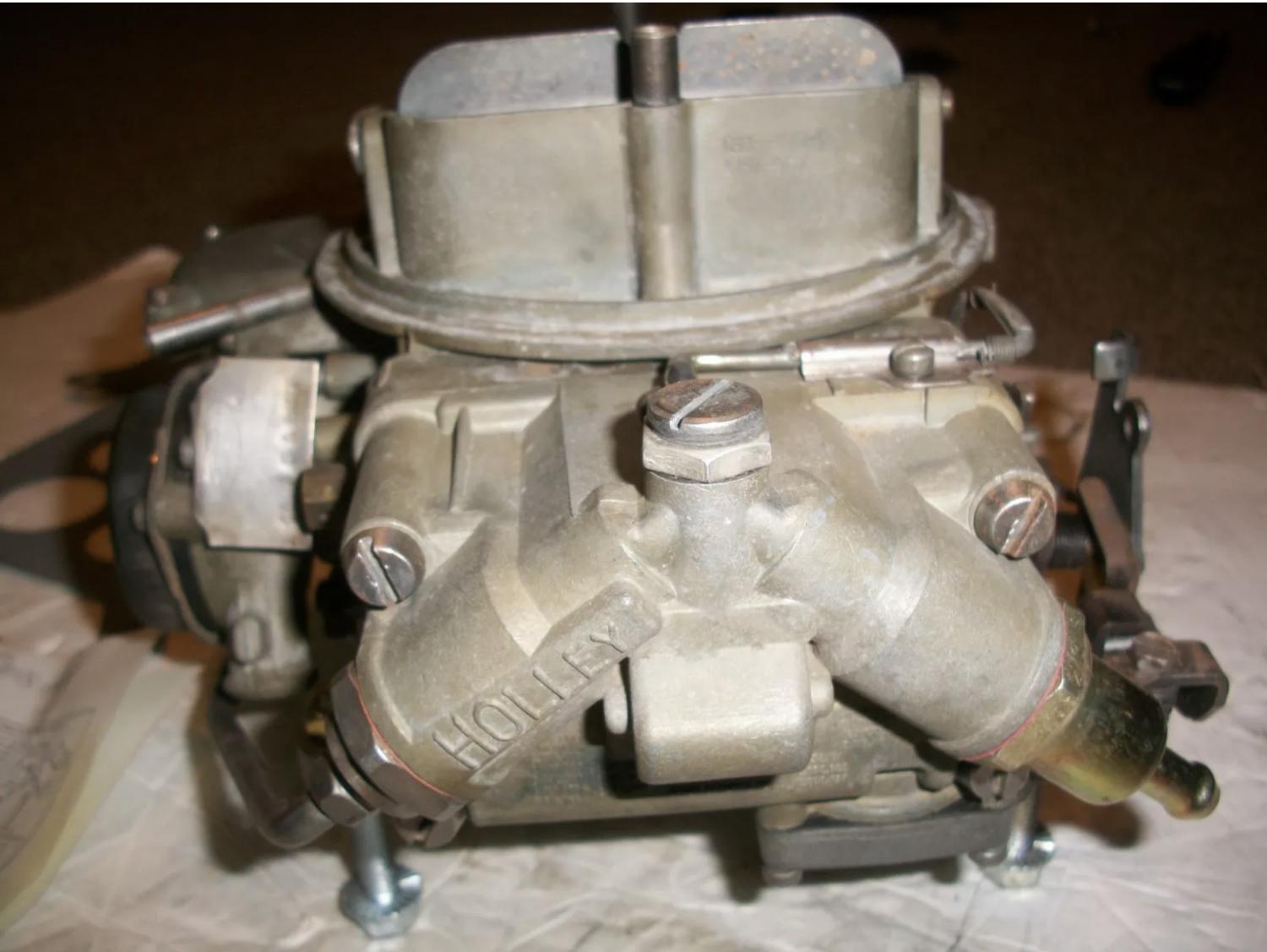

That is quite the fuel delivery set up there. Fuel delivered directly into metering block (stock.?) and gear driven secondaries. Bet that 428 was wound up more than a few times..

Vacuum advance, metering block to distributor.
I believe the fuel comes in the other side of the front bowl.

You're right, that is a funky vacuum source

The carbs on a Ford are different than a Chevy when it comes to fuel delivery. They feed fuel to the drivers side front fuel bowl filter then it transfers fuel to the passenger side, through the fuel tube, to the rear fuel bowl. The hose from the front metering block is going to the distributor for vacuum advance.
