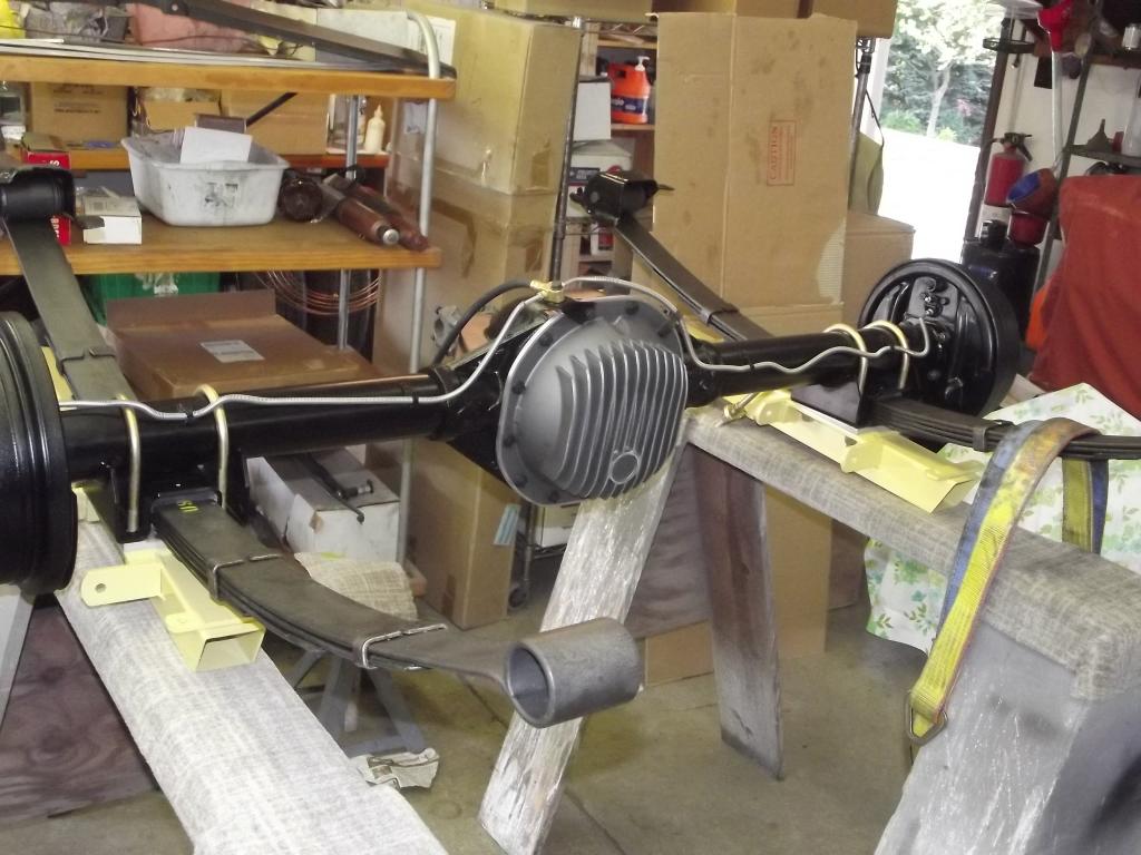

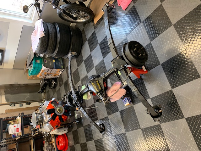

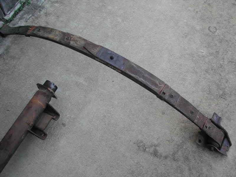

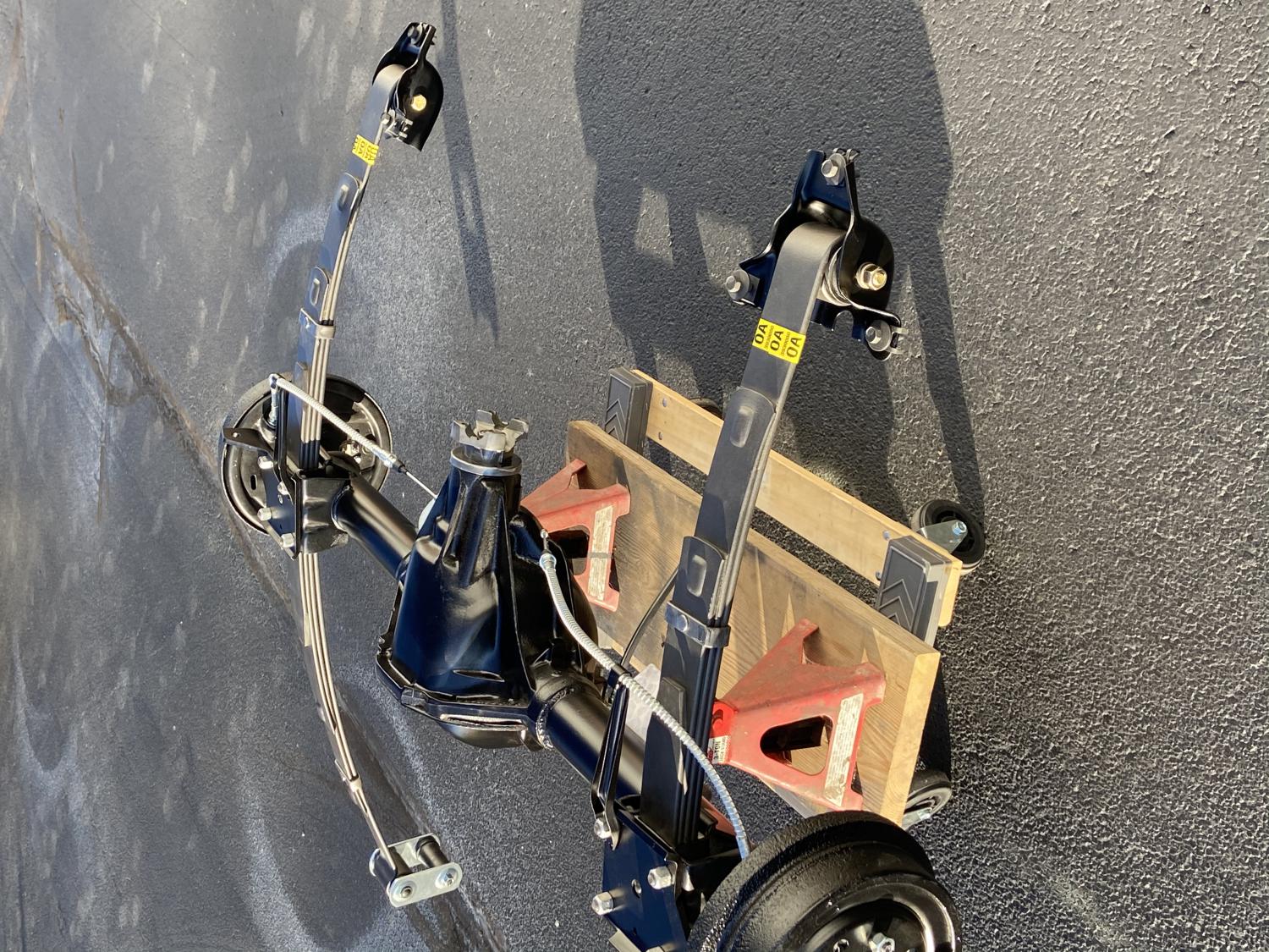

Over 3 days of researching this topic with the AIM, Here, CRG, TC and other photos and forum responses, there are so many different responses.
Bushings both pressed in from the drivers side?
Bushings direction doesn't matter?
Bushings pressed all the way in? Some guys say definitively yes.
Bushings centered? Some guys say definitively yes.
I looked at all the original car photos and there isn't much focus on this issue.
The restorations, both amateur and professional are also all over the place on this issue.
How about some photos of known correct orientation? Really appreciate it gents.

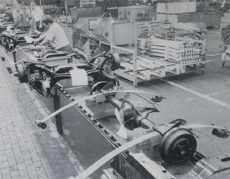

I approach it from a manufacturing perspective....on leaf springs where there is no "right" or "left", (one PN for both), and production even at that time would have been somewhat automated...at least fixtured, it makes sense that all front eye bushings would be pressed in from the same direction. As for centered vs not-centered, on my 70Z project, I copied an original set of leafs and the bushings are centered. Are there variables to this?...maybe...this has just been my experience.

I agree, assembly of springs would have them all going into the press the same direction, not right and left.

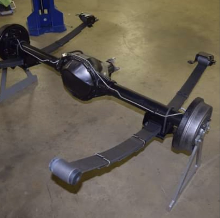

After seeing a few unrestored cars, they were pressed in from the driver’s side, so that’s what I ended up doing. Thanks guys for the input. 👍
Old 10-31-2020, 11:06 PM
big gear head's Avatar
Join Date: Mar 2012
Location: KY
Posts: 3,386
Thanks: 5,701
Thanked 1,474 Times in 767 Posts
Benny's car would be a good one to check.

Wow, everything is so clean and new.
Did you put the front mount clips and bolts on just to keep track of them ?

My 69 Z are both pressed in from drivers side, both centered, original springs
