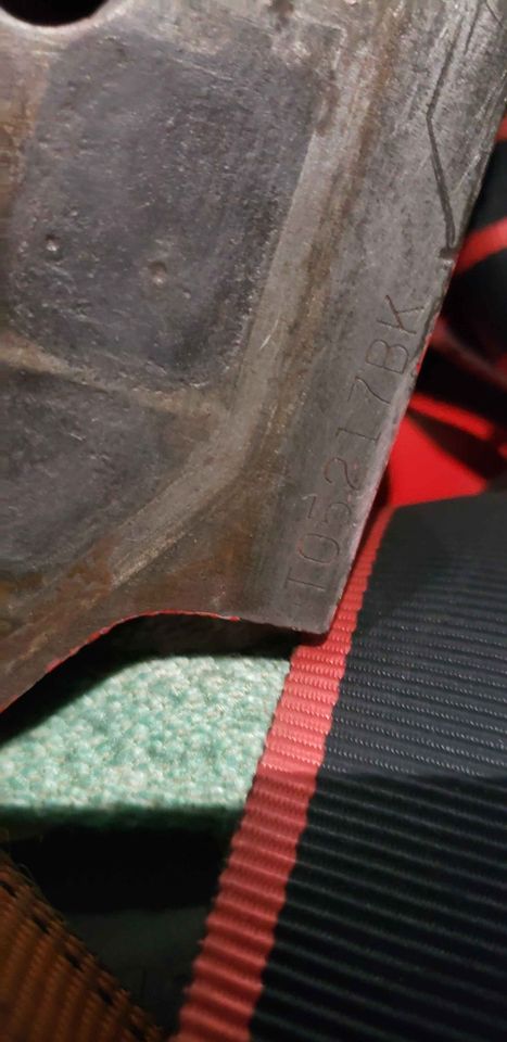

Someone of Facebook posted this picture looking for information on the engine in his 1969 Corvette. I couldn't find anything on a BK code big block. Anyone know anything about this engine? He said it is a 4 bolt 512 block with 842 aluminum heads.

BK boat code

Yes, the 7XX suffix is marine originally.

Boat Kode...

From what I remember:
B Code: Boat Code
C Code: Car Code
T Code: Truck Code

Thanks for all the responses. I relayed the info to the guy with the engine
