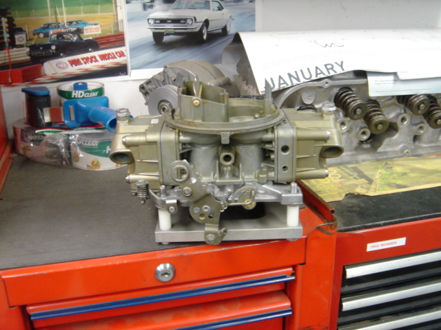

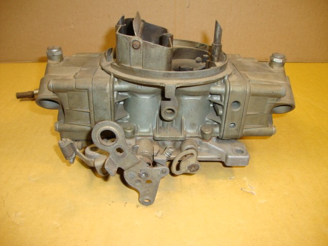

I just bought the almost gallon can of Berryman Chem Dip from auto parts store.
I did my Holley 7B3 4053 with it. Not harsh at all. Dipped parts for about 15-20 minutes. Easily cleaned carbon etc. off with a small brush. Washes off with water.
Original plating still intact. Parts came out very nice. I removed the old gaskets first. I read where it does not remove the old gasket material but I did not try that. Before and After pics.

Thanks. Basically they say 30 minutes soak time. More for extreme crud etc. They state that you can soak 4 hours to overnight but you will be at risk of removing plating etc.
This carb was nice to start with. All passages were checked before and after dip. I had a nice correct baseplate (also cleaned with the Chem Dip) to go with it not shown in the before pic.
I was very surprised at how well the Berryman worked. No smell and it didn't burn my skin.
