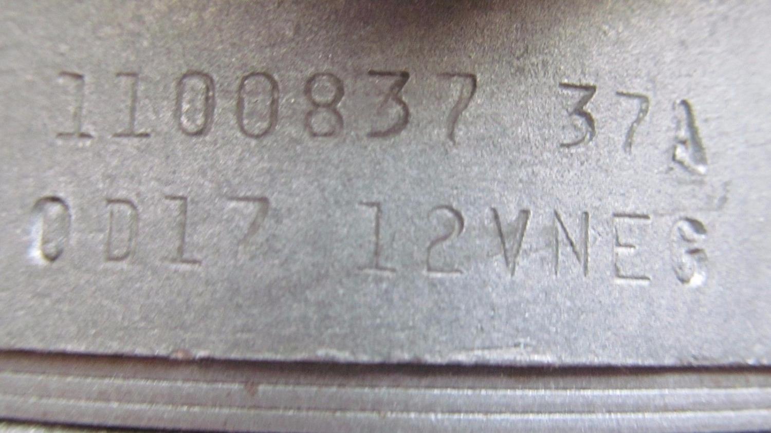

curious what the opinion is on this 837. price seems to good to be true...

I'm not really fond of any Tennessee sellers after reading this thread.
https://www.yenko.net/forum/showthre...=140881&page=4
Th HLA letters in the ebay user name line quite well with the seller/buyer mentioned. Use your own best judgement.

Is that supposed to be a D for the build month?

Avoid.

No comment on the seller or the price, 0D17 is a known date for a 70 837. This is the only one I have saved.

not saying that it's the case here, but I've seen stampers make an original 834 into an 837.
that 7 area looks kind of beat up to me.

Thanks guys. Search continues...

NG
No Fisher priced toys here

There is a good reason he now describes such items “as I received it”.
