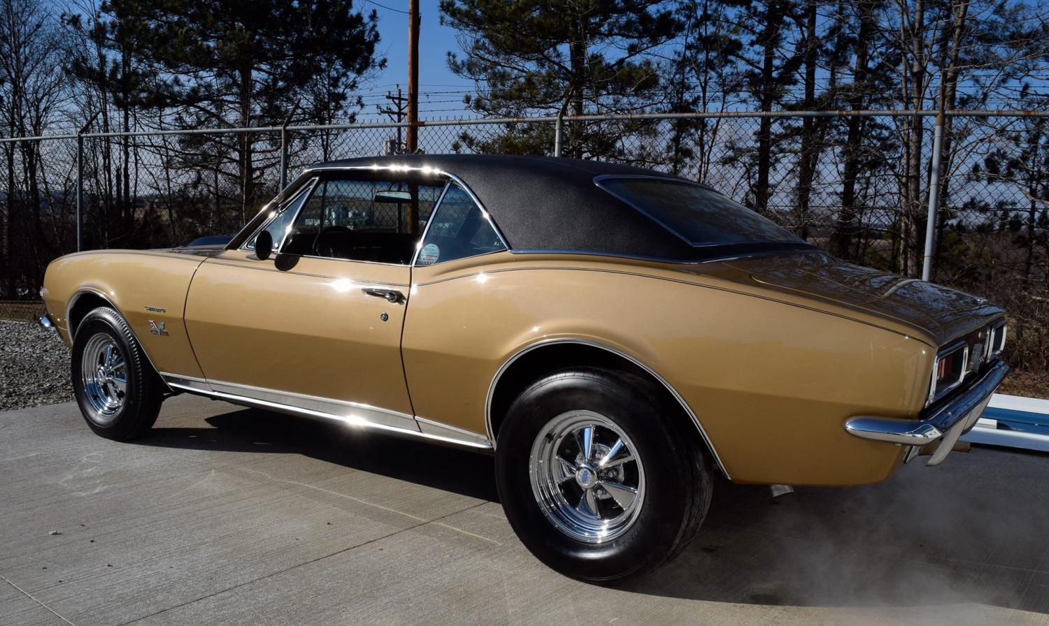

I’d like to buy a set of Cragars for my 67 Camaro, but don’t want to mess with the suspension at all. From your experience, what size rim/tire can I get away with in the back? I love the skinny/wide look like in this pic, but doubt I could do that without air shocks or something similar.

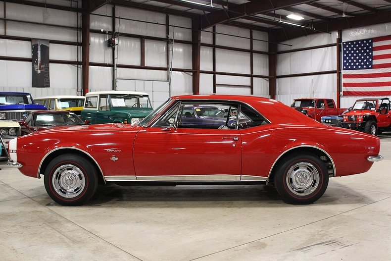

This the ride height of my car.

My cars ride height as about like your red car, maybe a little higher in rear. No air shocks or front mods. I run 15x4 in front with a smaller tire and never have rub issues. Sometimes you have to give a little on appearance to make things work,if you drive your car.
15x8 reverses in rear and I have to watch about getting it in a twist or they’ll rub on occasion .I’ll PM you the tire size I have later.
