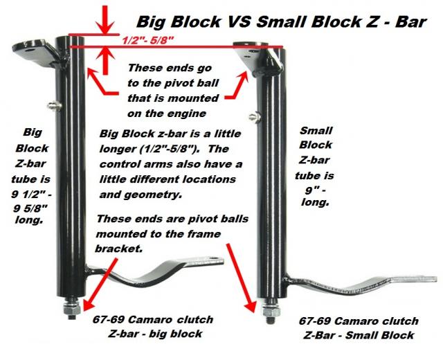

I'd like to buy this but looking for some confirmation before I pull the trigger.
What do you all think? I'm looking for a GM original bellcrank for my 454 build.
Thank You
Jose

If you're looking for an early Camaro Z-bar, the off-set bend is wrong...
I didn't see in your post what car you need this for...
Hope this helps... Crash

Thank you. I'm looking for my 1967 Camaro. Are you saying this is a repop or a gm manufactured part for a different car? My '67 has the early frame design but looks like the bellcrank part number is the same 67-69 according to what I've seen in the assembly manuals. Thanks again for your response.

If you compare this one where the arm that goes to the top rod is shaped, even though for a sbc, that arm is the same for either, you can see the one you are considering is different. It looks like it could have been cut a welded, iyam?

Thanks! I see what you see. The search continues...

Is it the same as 67 Firebird 400? I have a nice one off a low mile CA car.

The 67-69 Camaro Z-bar is unique to the 396/427.

This was posted awhile back...not mine but kept it for the difference in height.
