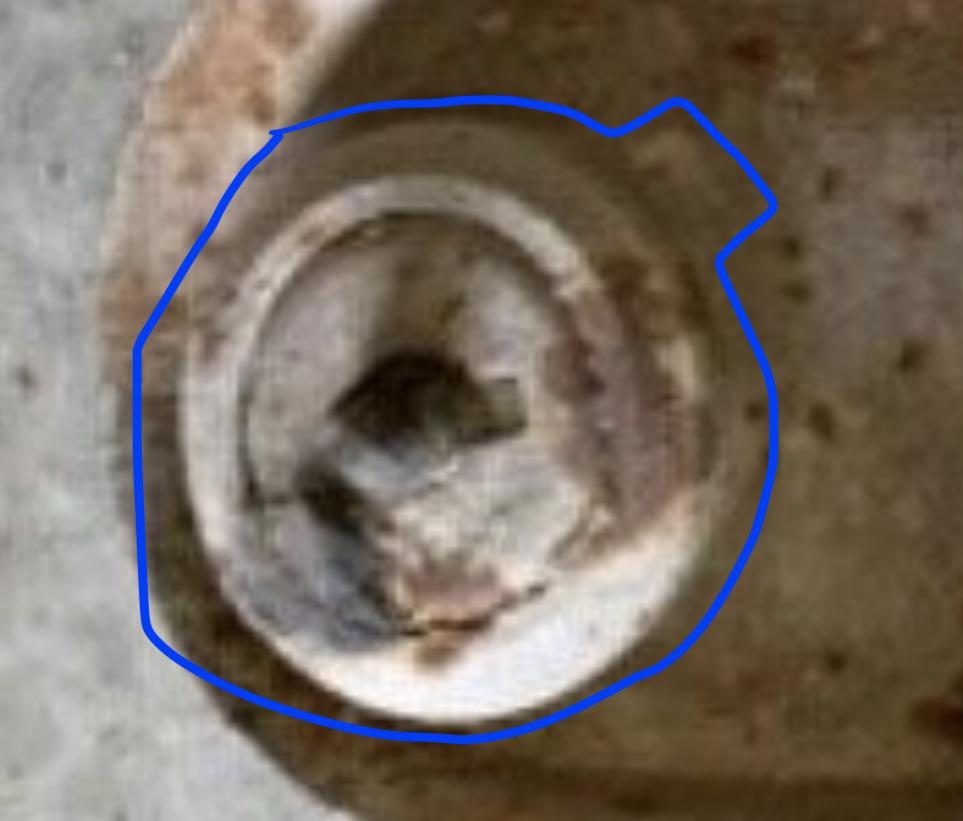

I recently realized that the NOS lower control arms that I had
installed in my 1970 Camaro LCA's were NOT the Correct (with Tab) Style
for a LEGENDS Quality Restoration.
I have other Control Arms with Correct Original Ball Joints that
Im wanting to remove, restore the cosmetics & install in my
Original LCA's

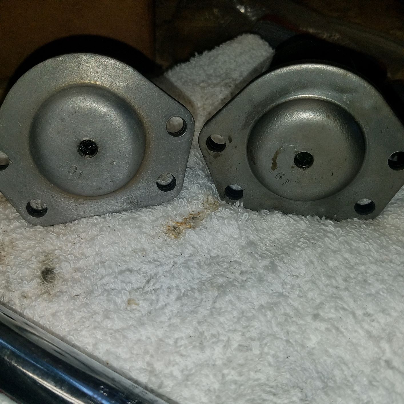

Can someone post pics of the lower ball joint with tab as opposed to the replacement ball joint?

Here is an NOS assembly line correct 70 Camaro lower ball joint with the tab for reference
