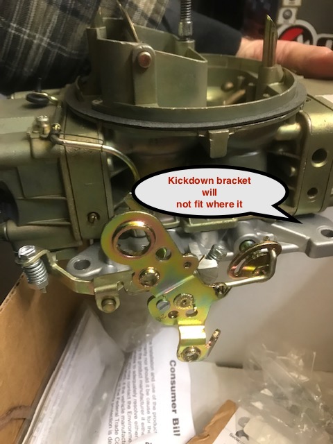

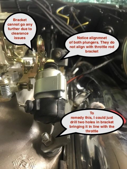

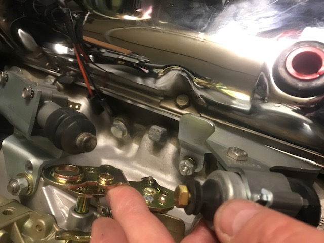

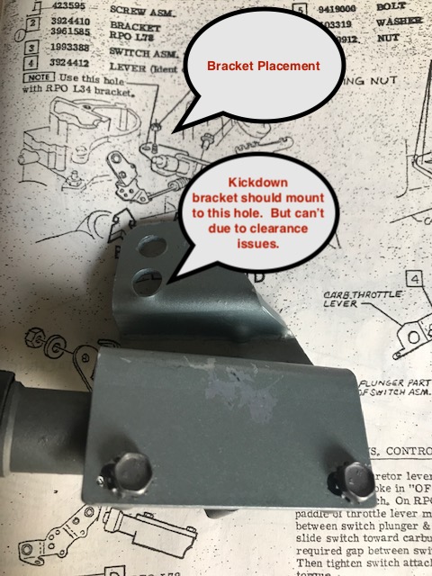

O.K. I'm stumped.
Some facts:
69 L78 with original carb and Intake manifold.
OEM kick down bracket.
Re-produced Idle Solenoid bracket I got from Bob H @ Camaros.com, I was in the hunt for that rare bracket and he had one on the shelf. But it was made by a guy who did a few of them years ago. It looks dead on, compared to others I have seen pics of. But I can't put it side to side with an OEM bracket to see if there is a difference/flaw.
The Problem:

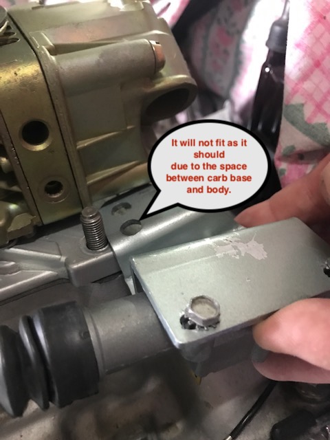

Both brackets/solenoid plungers do not line up with the throttle rod bracket. They are almost a half inch away from being in the proper position in order to function as designed. The kick down bracket will only mount in the hole designed for the L35-L35, it will not slide under the carb base and carb body due to clearance. Carb was restored by Eric and I contacted him and he assured me all is correct regarding the carb and its brackets.
I contacted the Tech Dept. of BBBenny and he sent me pics of his survivor L78 set up and mine just does not seem the same. Attached are a few pics of my dilemma. Those of you with the same set up and or corporate knowledge, could you please give me advice as to how I can fix this? Any and all advice is appreciated. John

How much are you missing the hole by? .0125?
Have you tried flattening the area which appears raised by the hole using a vice? Or retaining in a vice and using a brass drift and hammer to flatten? It may get you a little more clearance, otherwise I would grab a chainsaw file and elongate the hole slightly, the retaining nut with washer will cover the additional area of the hole.

Yes. I need about .0125. And my solution is as you recommend. Get a rat´s tail file and work a bit at a time. The other issue with the Kickdown bracket is similar. I just need to file the bottom side of the bracket until it will slide in place. When the carb was rebuilt, the base was milled down, and that took away that small gap needed to get the kickdown bracket and vacuum pipe in place. Bottom line...problem solved. Now onto the fuel lines and Y block. I have bought 3 different sets of lines and not one set is the same as the other. But I will say this, the set from Fine Lines WWW.SSTUBES.COM in Ohio, fits the best.

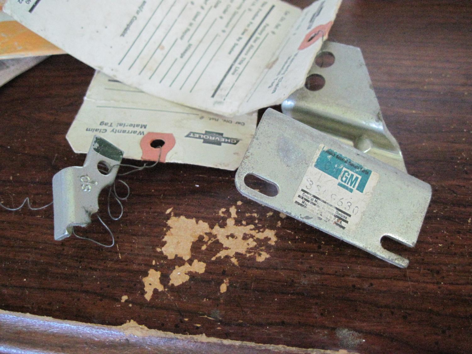

The extra hole for the Q-Jet carb on the kickdown bracket is sheered off originally between the holes. That way you are able to use that bracket on a Holley Carb.

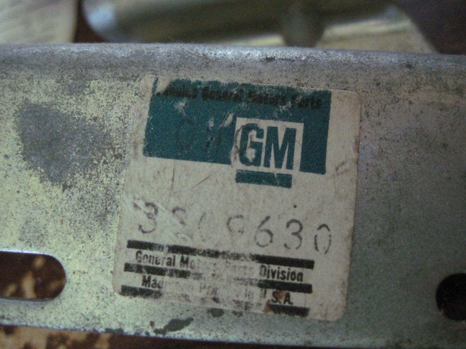

I have these if it helps.

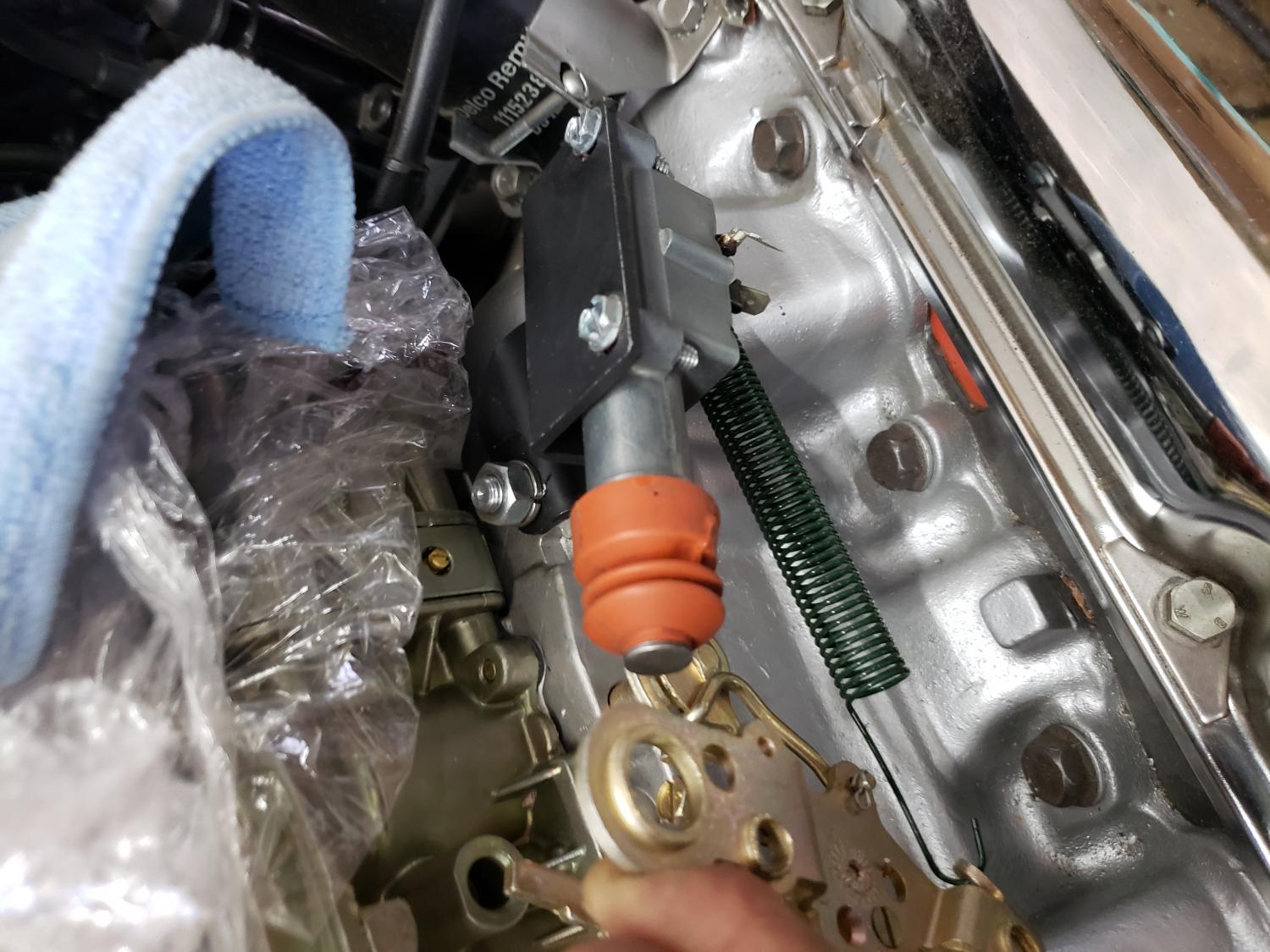

I somehow figured it out I will send you pic tomarrow when I am with the Engine.
Old 06-08-2020, 05:46 PM
dmarr35 dmarr35 is offline
Join Date: Dec 2018
Posts: 62
Thanks: 14
Thanked 32 Times in 10 Posts
Old 06-08-2020, 05:54 PM
parkbrau's Avatar
parkbrau parkbrau is offline
Join Date: May 2007
Location: Stuttgart, Ge
Posts: 557
Thanks: 193
Thanked 159 Times in 66 Posts
Thanks! That shows the extra hole is sheared off. And I’m confident the vacuum pipe will fit there as well.
