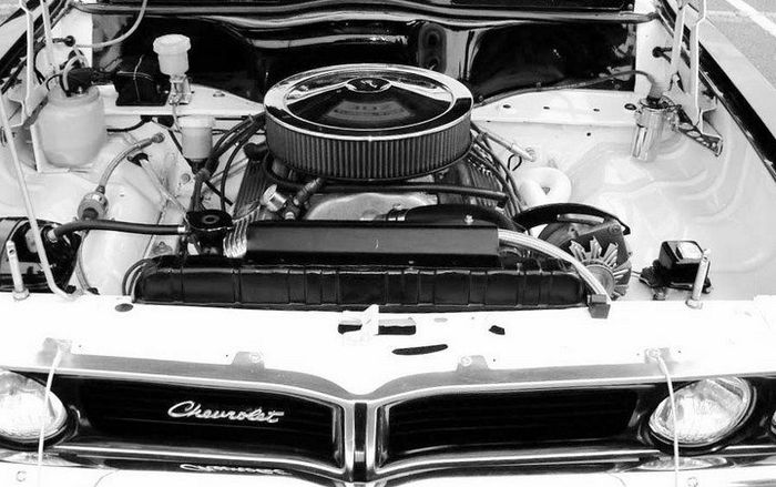

Apparently only 100 such Canam cars were made to meet certification requirements. However I can't recall if the engine was dressed similarly to a Camaro 302 (brackets and ancillaries) but did find this picture showing the engine bay; looks like the alternator was relocated to fit the available room, so bracketry was probably unique.
Note that pictured engine bay may not be stock though, as many of these cars were highly modified for competition use.
