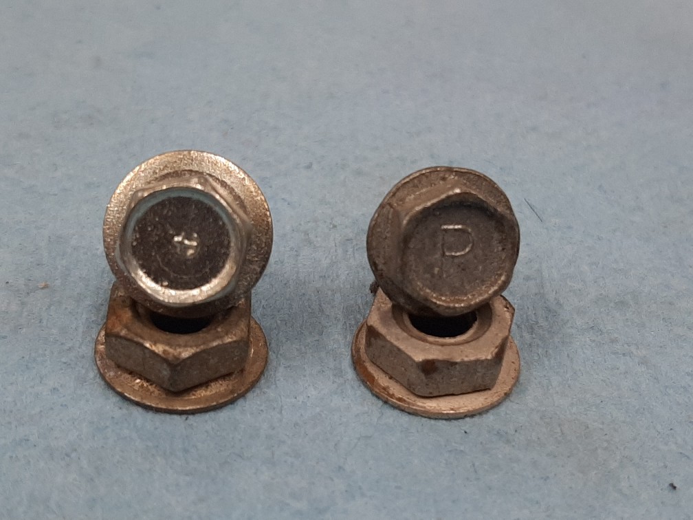

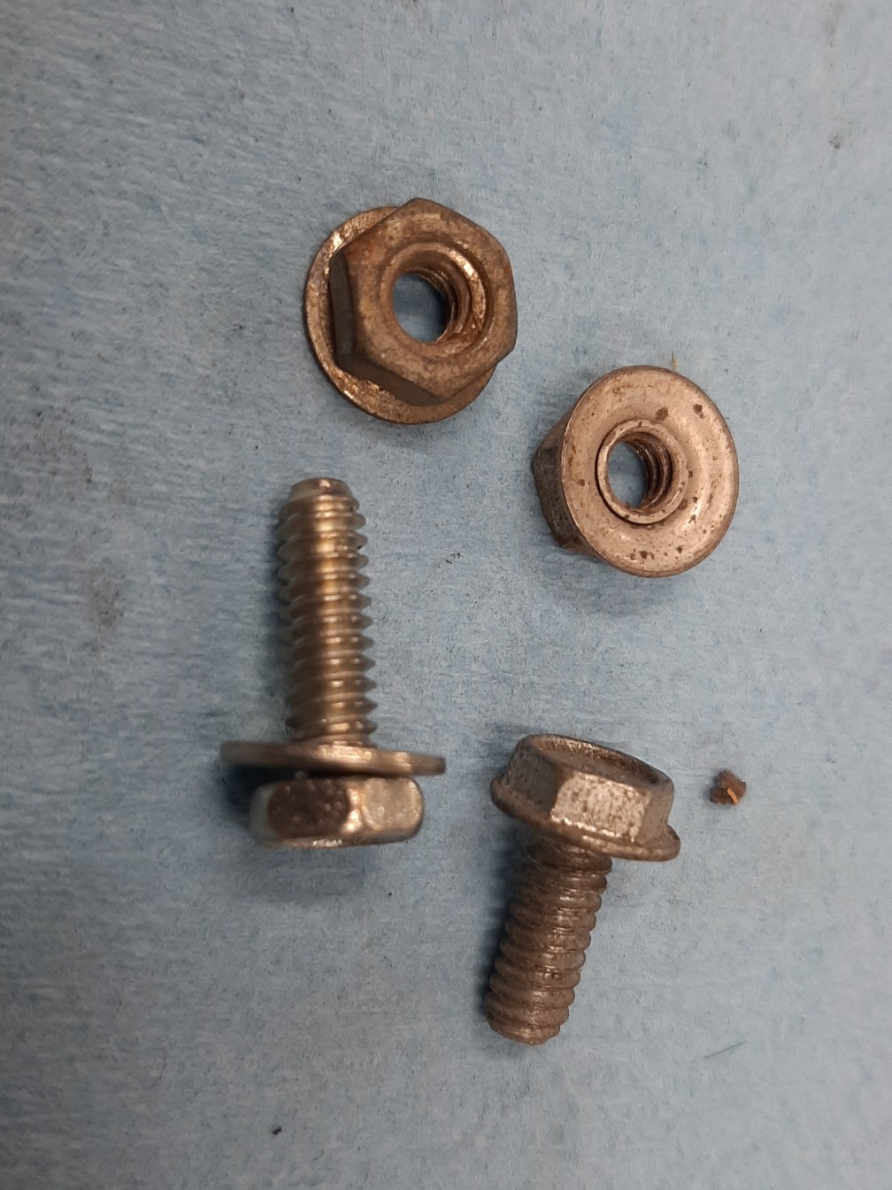

Any one have a picture of the original fasteners used on the front spoiler ? Thanks

They used 2 different style bolts for the front spoilers, one is the recessed flanged head and the other has a recess to head with a captured flat washer. All of them used the nut with a captured flat washer

Thanks ,that helps
