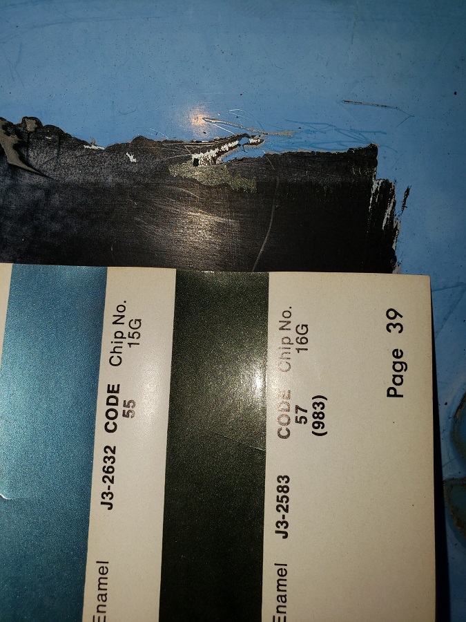

I am still trying to establish some validity to my 69 Camaro actually being a SS396 so i scraped some of the robins egg blue (yuck) off the tail panel and the results are below in photo.
So matte black, or body color...which can i hang my hat in?

AFAIK, all 1969 396 SS Camaros had the matte black rear panel. All other Camaros had body color (SS350, COPO, Z/28, RS and STD). Only one exception was the 1969 396 Pace Car convertible. That would be white (body color)
The tail panel and black out area would have a 60% gloss. There is a debate as to the percentage of gloss, but definitely not a matte/flat finish.

Charley and I have had a debate on the % of gloss. I would paint it 60% gloss. Obviously as you polish the blackout paint it will become glossier over time. I would not paint it flat/matte. JMO
I use matte as a generic term not specifically matte. I am more concerned for body color vs "not real shiny" black tail light panel.

I'd paint your tail panel black too.

The way I describe it is, it's shiny but not shiny enough you can see your reflection. Lacquer straight out of the gun can sometimes produce the same effect..Joe
