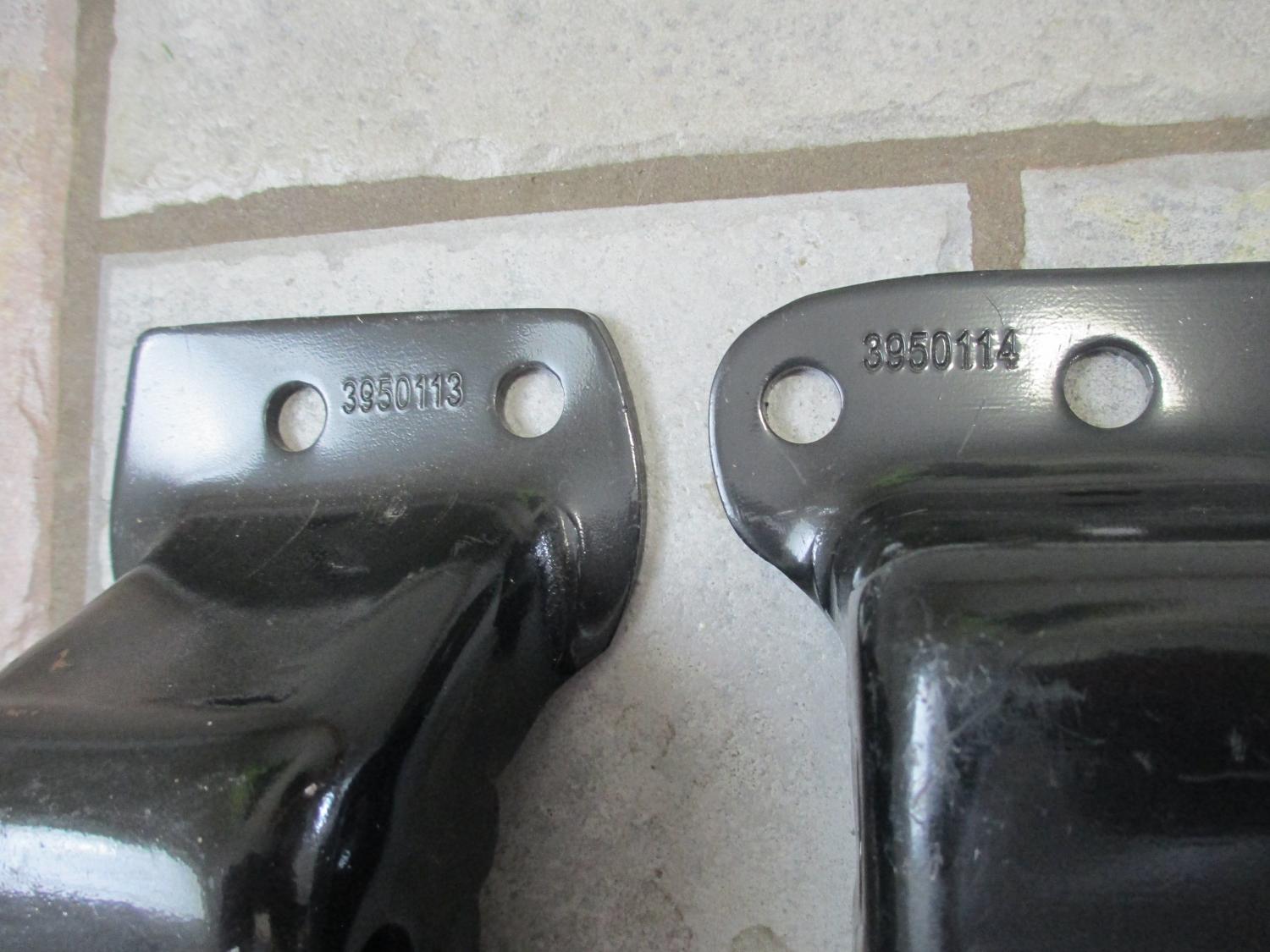

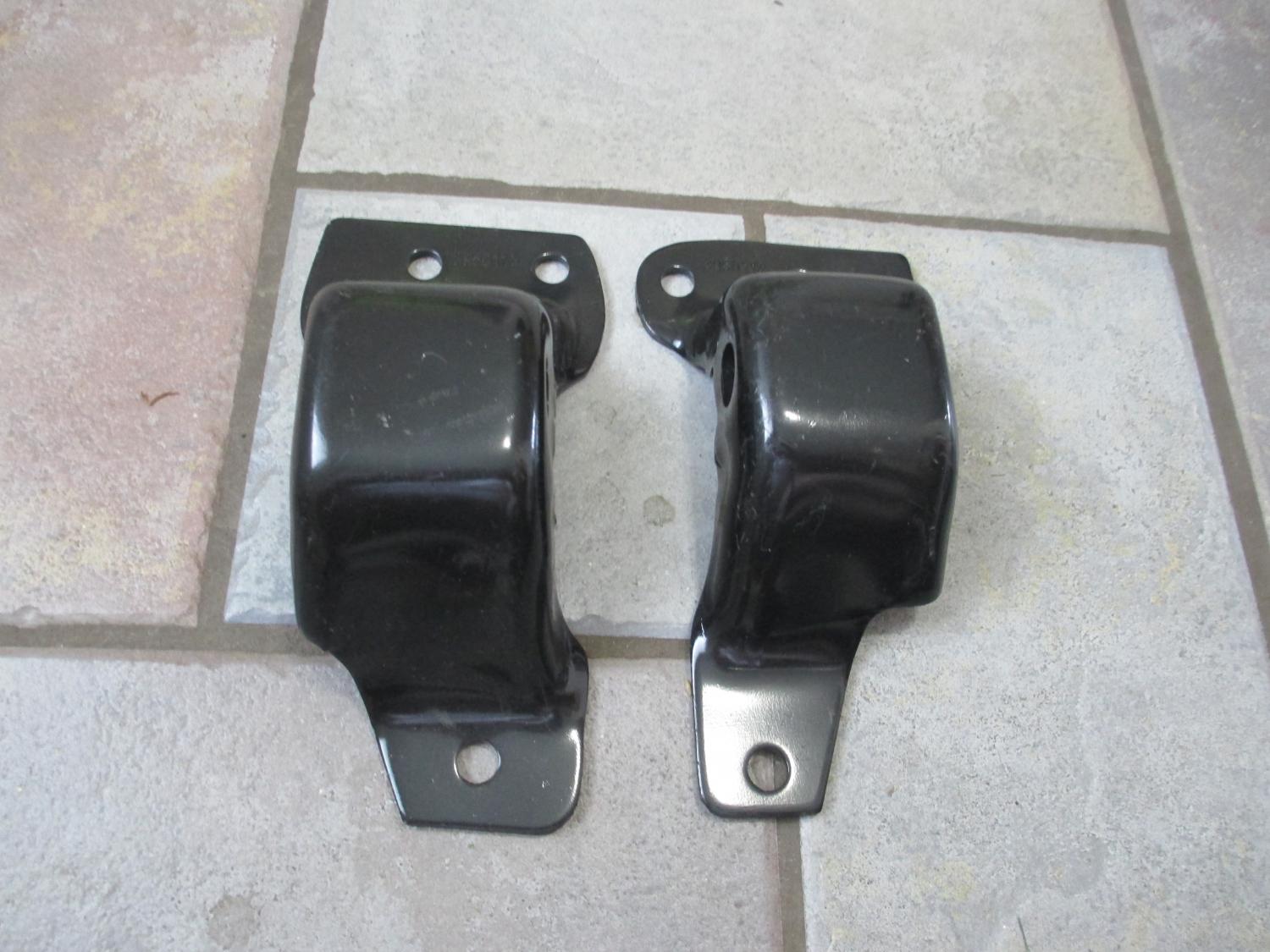

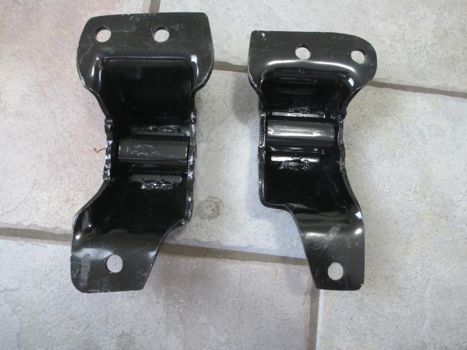

Can you tell me if these are original or repo?
69 Camaro/Nova frame mounts # 3950013-3950114

Those are repops.

OK, I got to ask. How do you know? What gives it away?

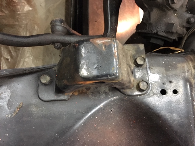

My originals do not have the entire part number stamped, just the "13" which on mine is very light between the two mounting bolts. There is also a symbol on top.

Easiest tell tale is the wrong fonts and the numbers are too big. Also repos dont have complete or correct radiuses .
