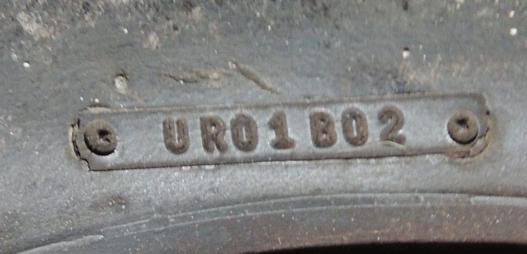

Hey gang,
Attached are photos of a vintage BF Goodrich G78-15 Silvertown tire. It has a DOT stamp on it, so I believe it is post '66. The date stamp doesn't seem to coincide with the DOT regulated procedure, though, and seems to fall in that period when manufacturers were using their own date code procedure.
I'm hoping there's a tire date code expert out there who may be able to help me out with this one? Thank you for your time.
I think that's post Dec 70.....

I think Kurt is correct.
https://www.federalregister.gov/docu...-recordkeeping

Thank you, Kurt, and Lynn. Lynn, I know you've been involved in some other conversations about dating tires. What's interesting with this tire is the DOT stamp isn't near the TIN, it's on the other side of the tire. That is what made me think it was pre-71, as the tires I've seen from 1971, 1972, 1973 have DOT right above the TIN. The TIN on this spare doesn't seem to follow the standard code set by the DOT, which made me think it was still when the manufacturers were still using their own in-house date codes.

Jeff: Here are pics of the date code on the spare in my 70 LT-1. I believe it is a March of 70 build. I was just looking at it today, and found the DOT embossed, but did not notice where it was in relation to the tin. Should be able to look on Friday. It is the original spare. Sadly, it is a Goodyear, not a Goodrich, so not sure they used the same date coding system. I do not believe they were standardized to the same extent VINs were standardized.
You can see in the second pic, the DOT marking is not right by the tin.
I would bet the tire has been replaced.
