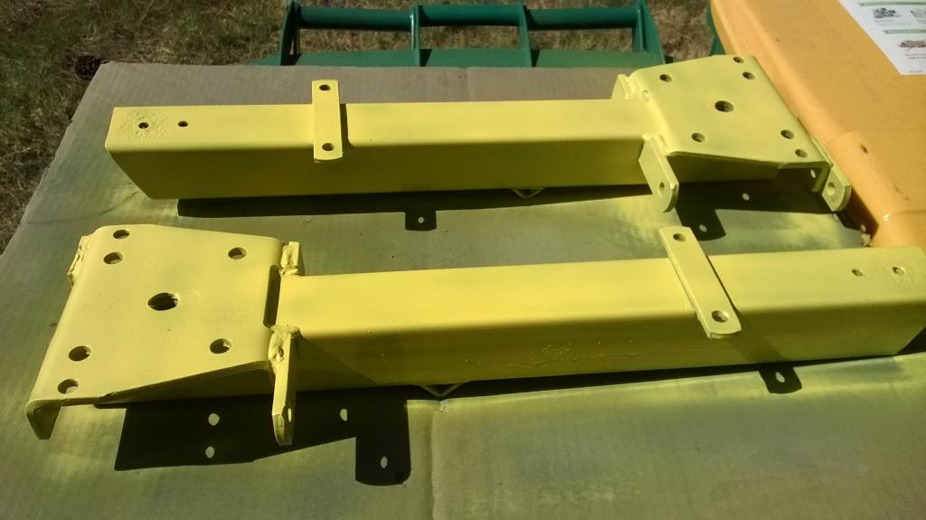

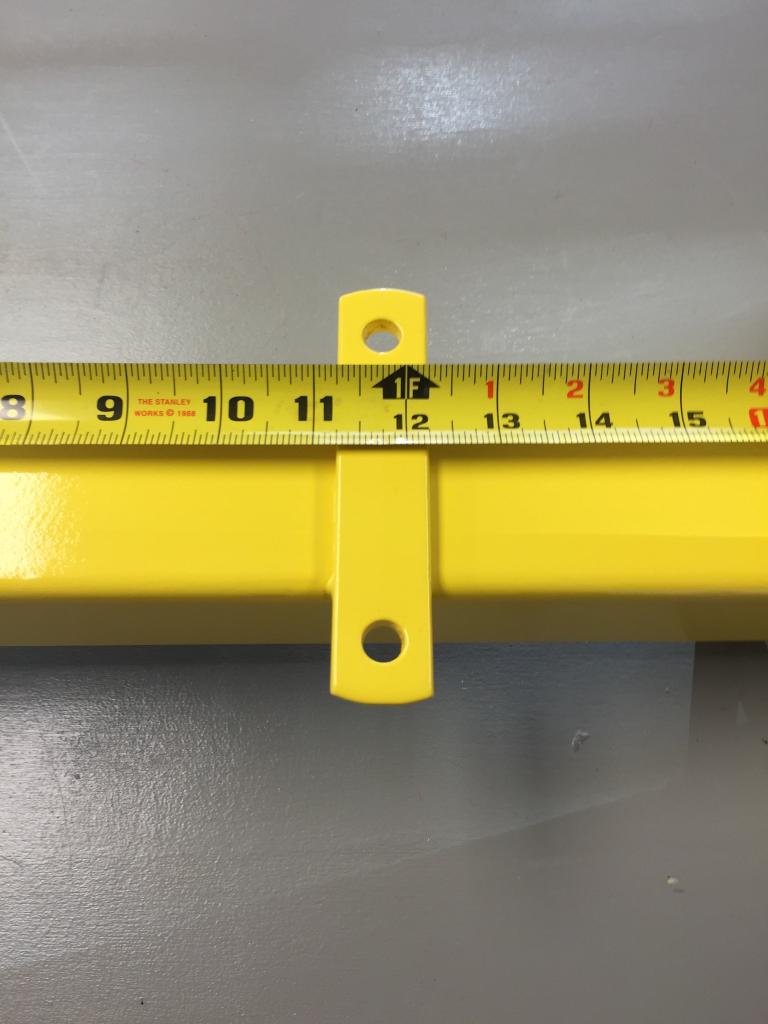

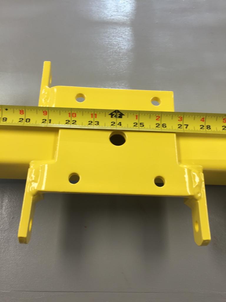

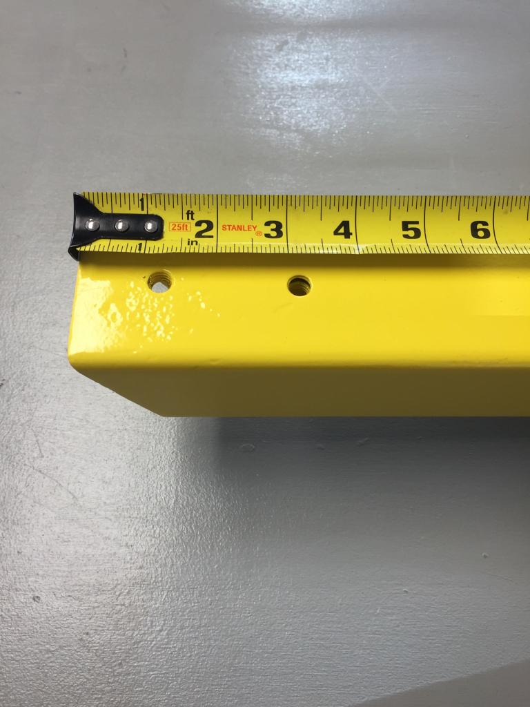

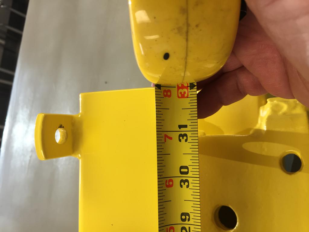

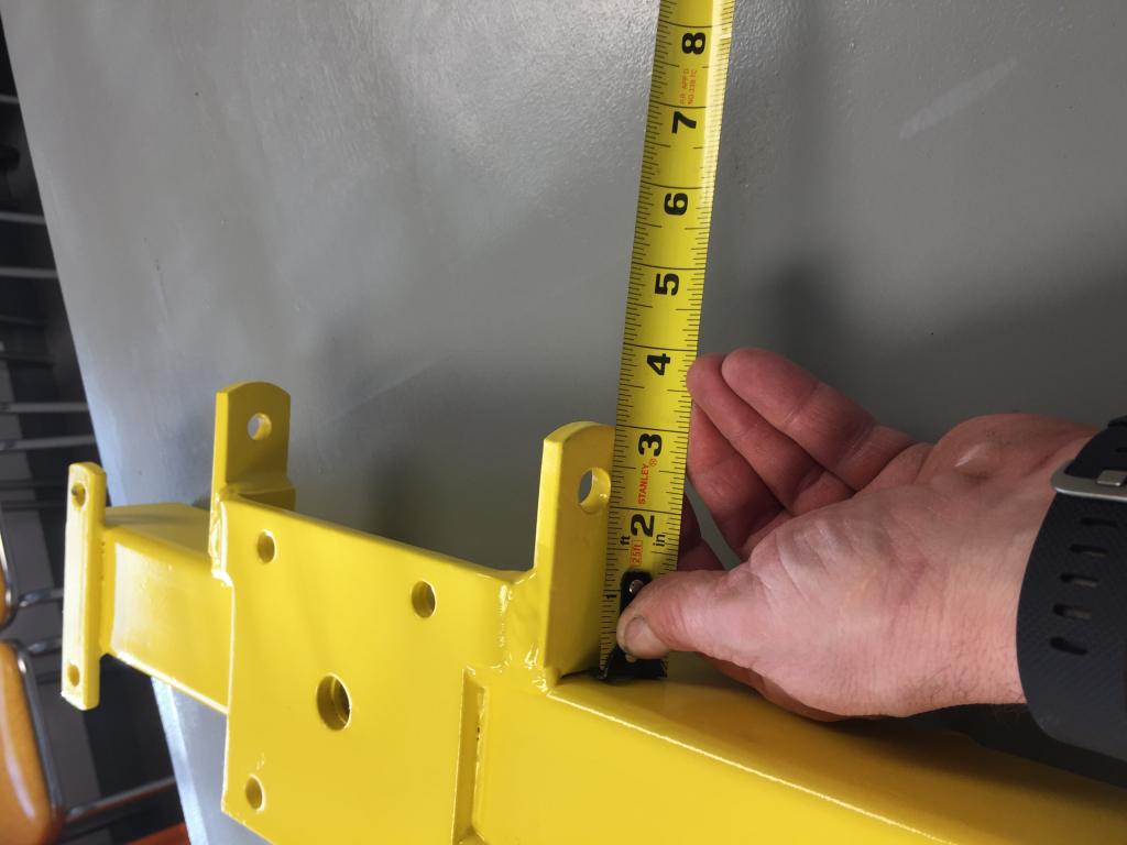

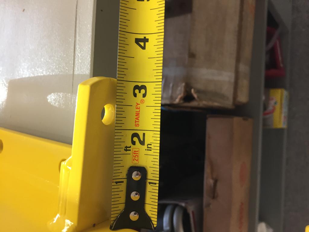

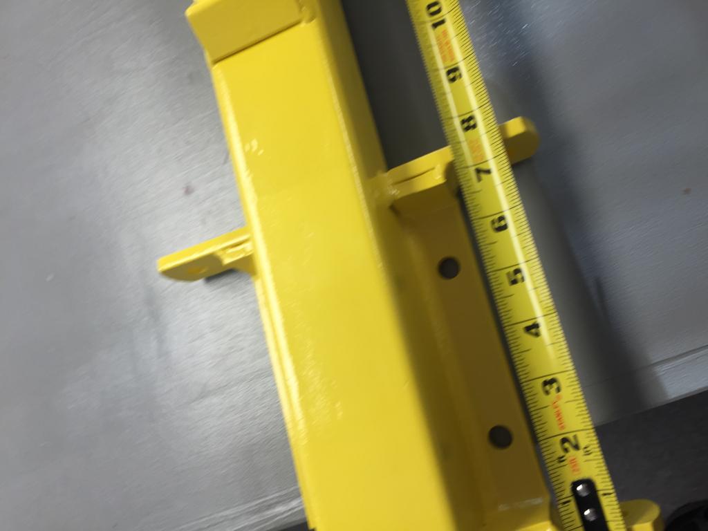

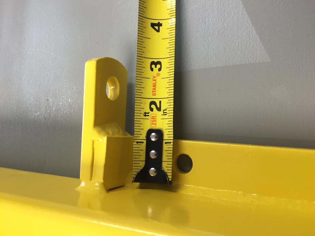

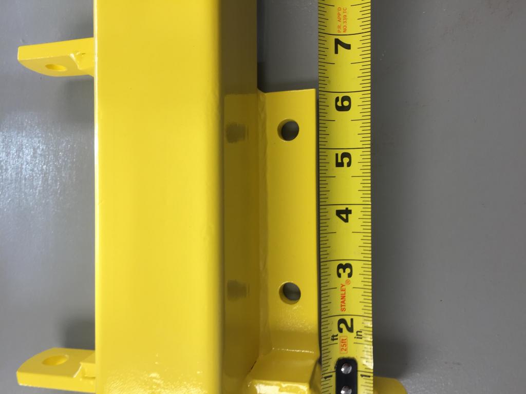

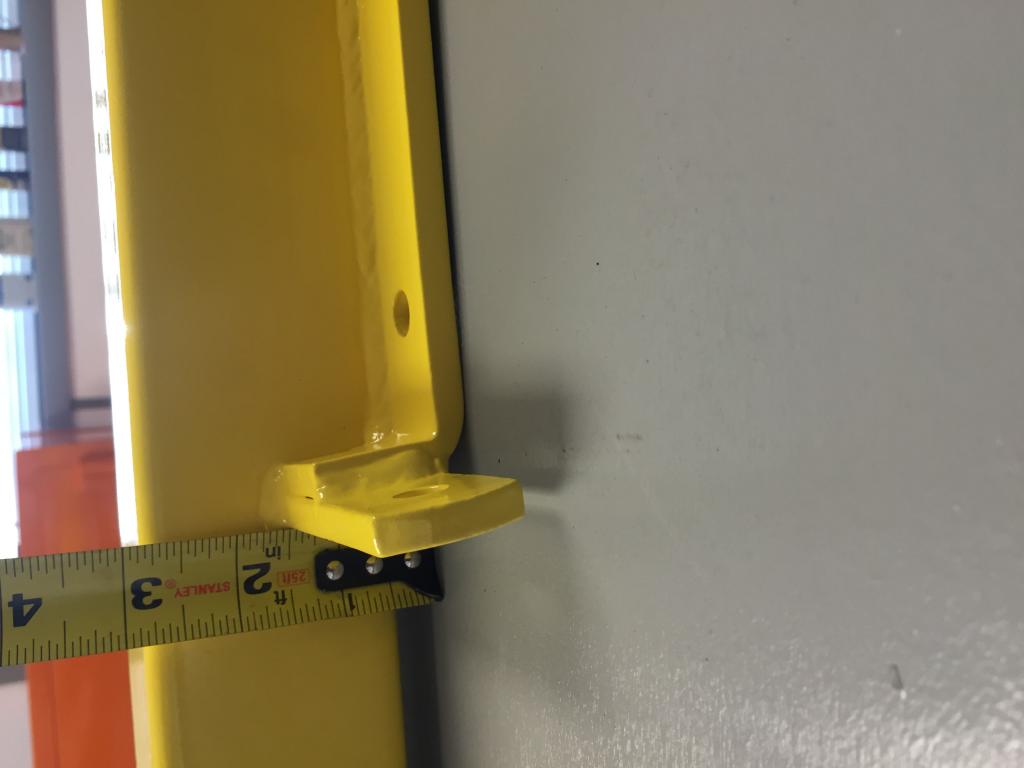

I have had a bunch of people ask for the measurements or drawing of the long tail square traction bar. Well a drawing is not going to happen ( a can't even make a stick person look like a stick person). So here are a ton of pictures with a tape measure. Hope this helps you guys.

What? Cannot draw [img]<<GRAEMLIN_URL>>/no.gif[/img] You just had a sketch painting class recently [img]<<GRAEMLIN_URL>>/naughty.gif[/img]
Very well done

Nice job, answers many of my questions. Thanks. This post w/pics will certainly &quot;gain some traction&quot;. [img]<<GRAEMLIN_URL>>/no.gif[/img] [img]<<GRAEMLIN_URL>>/scholar.gif[/img]... [img]<<GRAEMLIN_URL>>/beers.gif[/img]

ChevyandPontiac, I could use an overall picture of a tape measure from the back to the front to locate the spring plate and front strap for the u-bolt I've got most other measurements I need. THANK YOU for taking these pics! I have drawn up some more detailed diagrams if anyone needs them - so PM me your email and I can get you what I have so far

Many thanks to the OP for the great photos!
