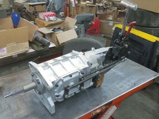

Here is one of my Super Shifters mounted on my new AutoGear N24. You can see that the shifter is mounted much higher and a little to the left.
Freddie
