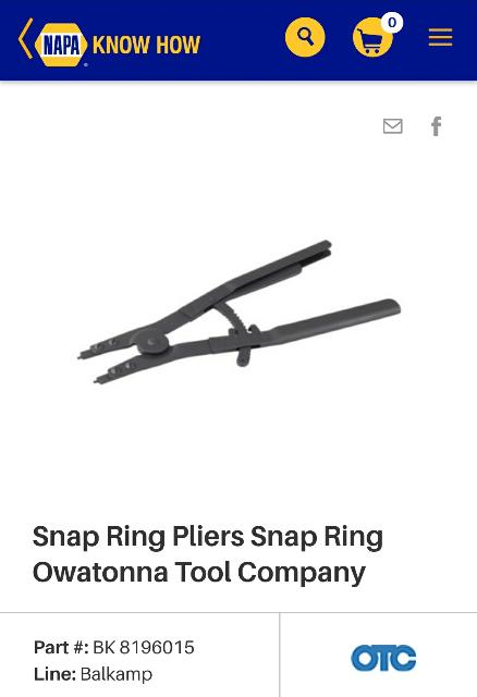

I had to find a set today. One of our tractors has tracks instead of tires and 3 of the bogie wheels were leaking. Our pliers were not big enough and NAPA was the only place close that had a set. They are about a foot long. The snap ring was 4 inches and felt like that thing was ready to fly off and do some damage!! The pliers have teeth that catch and you dont have to keep pressure on them the whole time. Worked really well
Bill

Those are similar to mine but the rachet on mine goes more straight across the handles. When you squeeze it, the next tooth catches and is a nice feature. Mine does have a lever along the handle to release the rachet. I tried to get a picture today but my phone wouldnt resize it for some reason. I will see if I can get something.
Bill
