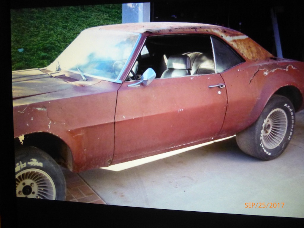

Yes, Gregg found that very set up. I saw it when he brought it home after pulling it out of a California field.

Gregg, how about some current photos?

That is so killer...

Whose car is this? 307 V8 with AC:
