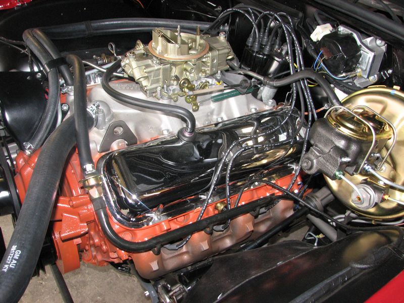

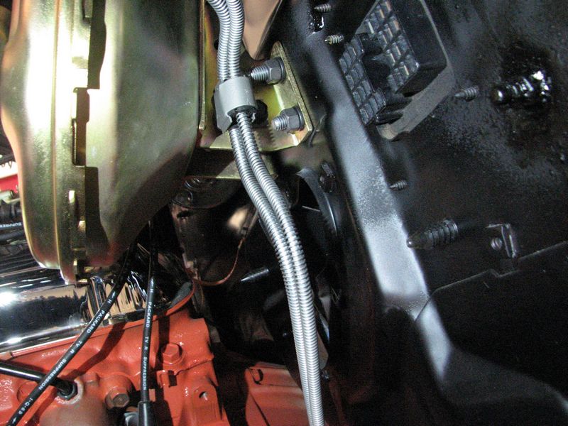

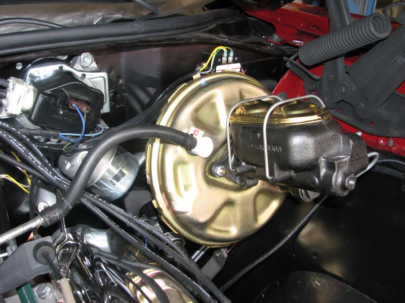

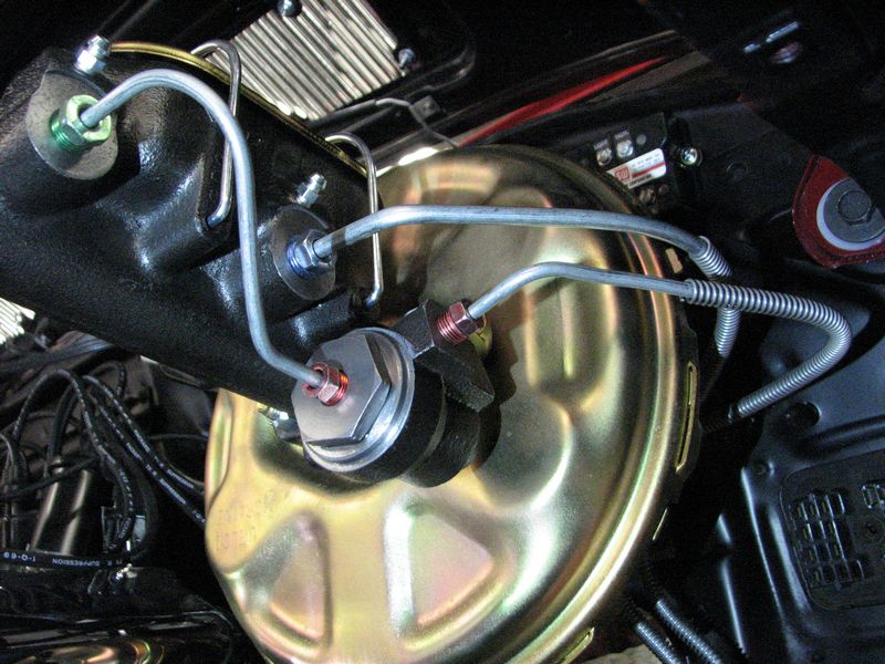

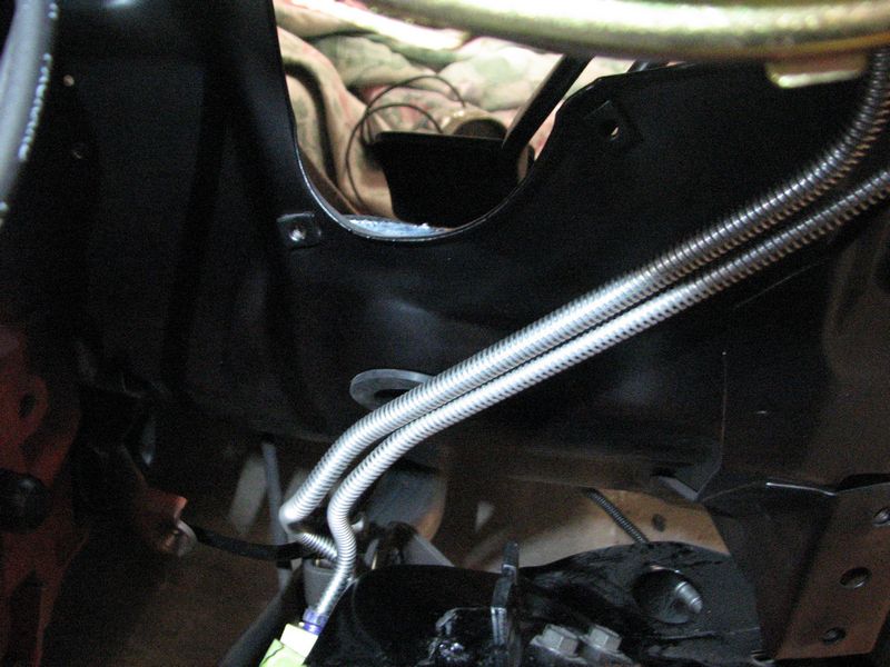

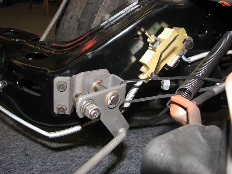

Looking for clear pics of 69 Chevelle SS brake booster /master cylinder and valves. Trying to bring one back from the dead. Thx

If this is not what you are looking for let me know and I will get you others. Not an SS but the same arrangement.

So the combination valve is down on the frame?

Yes
