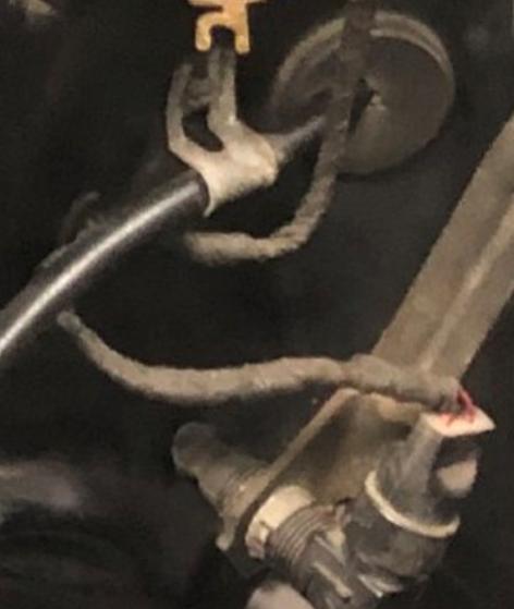

Hey everyone!

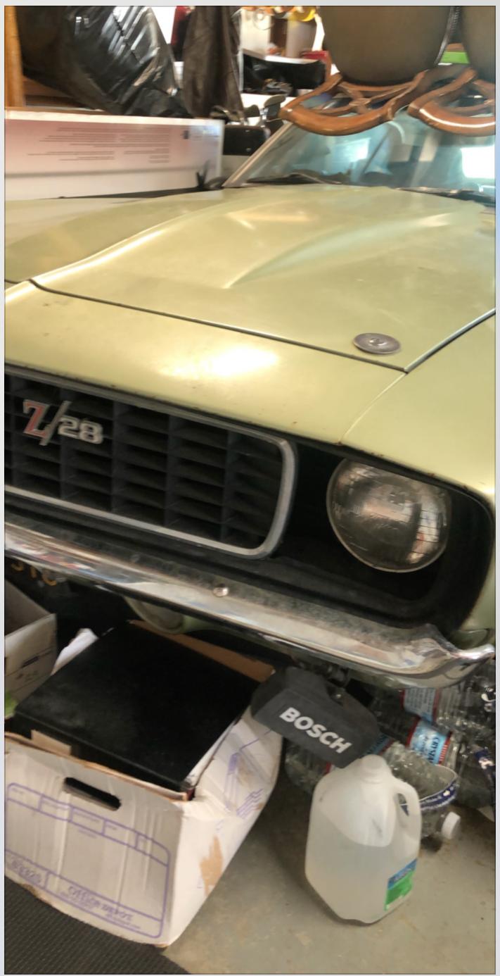

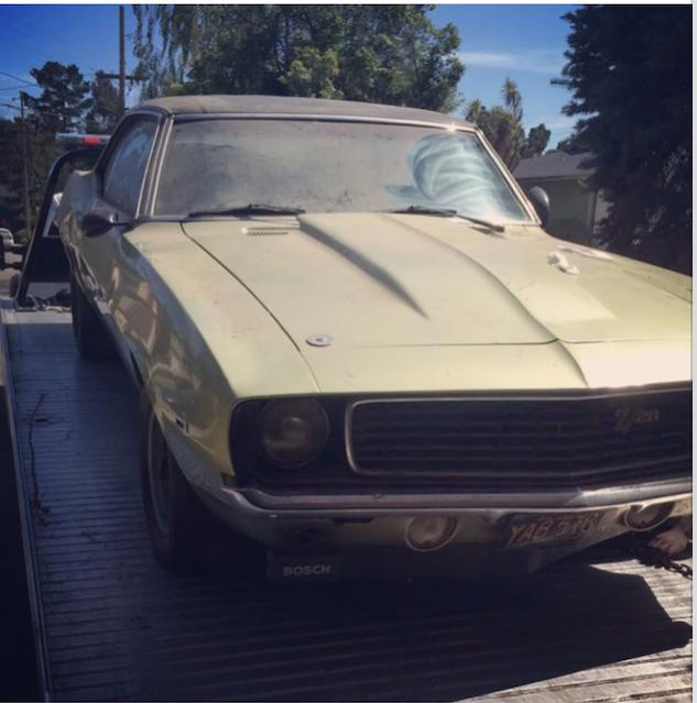

I am currently working on a project and trying to figure out if my 69 vinyl top Camaro is a true Z/28.
It has Z/28 emblems but we all know that could be just a cover
The engine block number is 3932386 and the VIN is 124379L504274.

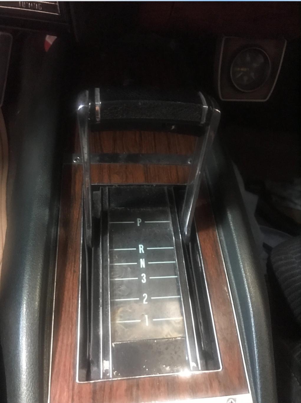

The only thing that makes me not think it is a true Z/28 is because it has an automatic transmission. This could have been changed though? Photos are attached
I appreciate your help!
Attachments - The Supercar Registry Z speedo cable.jpg Screen Shot 2020-06-22 at 8.20.27 AM.jpg Screen Shot 2020-06-22 at 8.20.13 AM.jpg Screen Shot 2020-06-22 at 8.19.24 AM.jpg

For starters, check the configuration of the original speedo cable routing.
If it was routed horizontally under the wiper motor, [see pic] behind the engine and down the trans tunnel, it was built with a Muncie 4-speed. Doesn't make it a Z/28 but a good indicator. Even if the cable was removed, the hole will still be there.

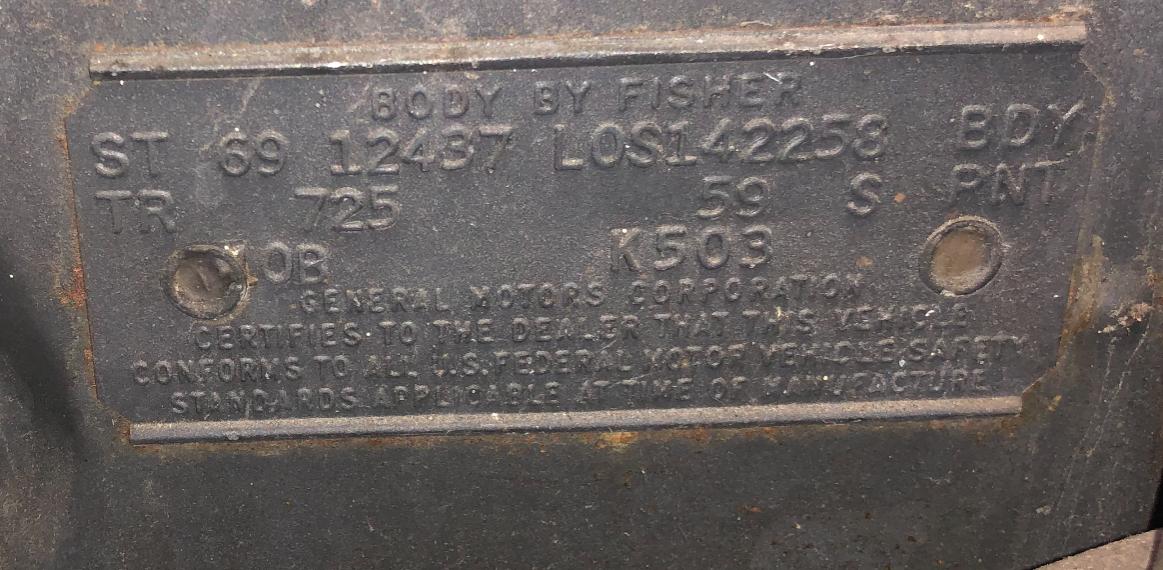

FWIW - the car's production date 10B and vin L504xxx means that the cowl induction hood was added at some point in time.

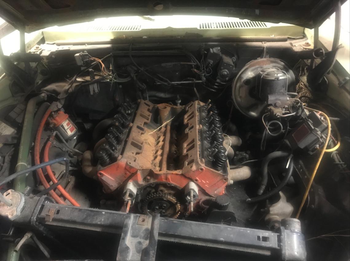

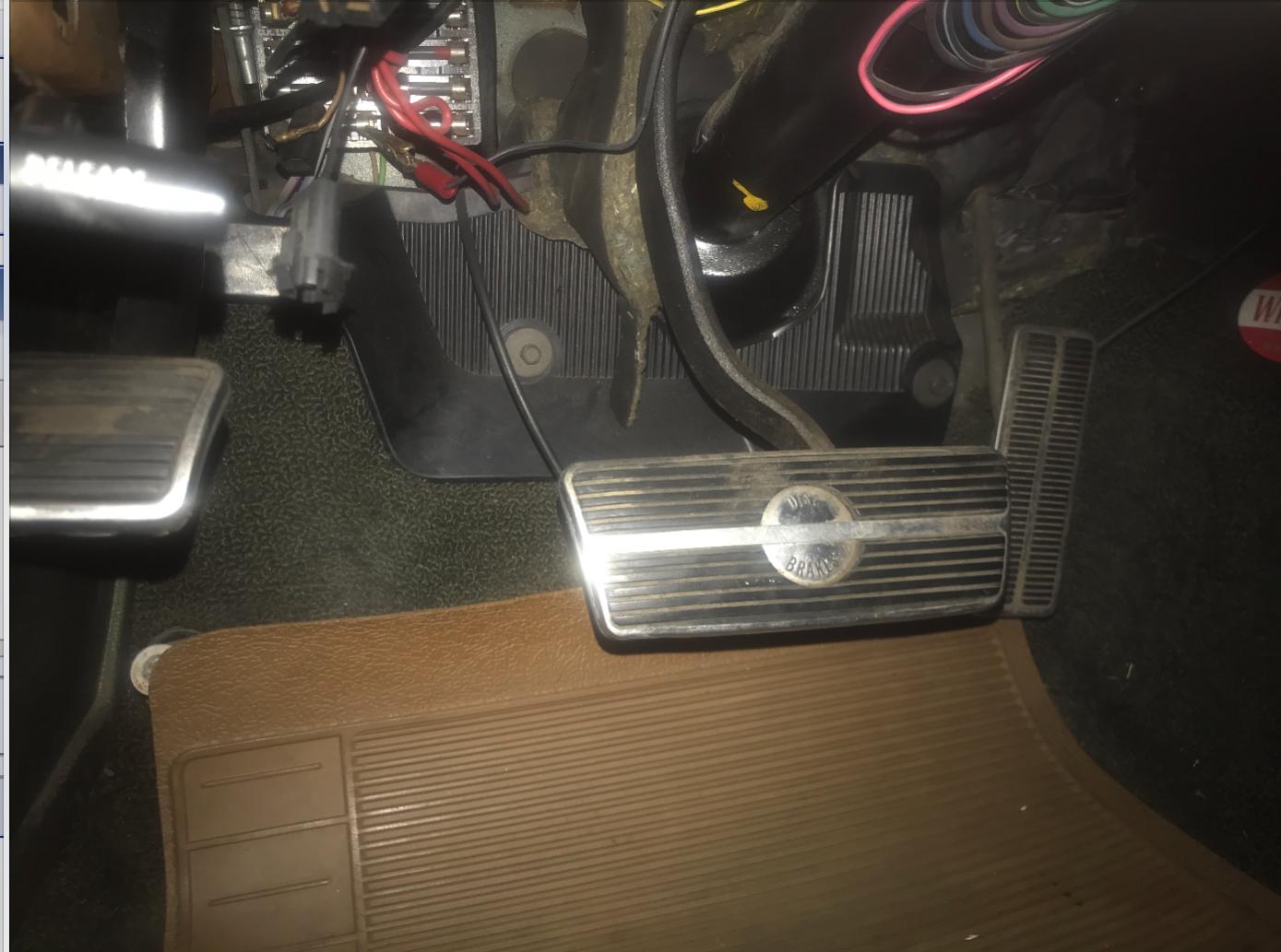

Hey everyone,
Here are some photos. Not sure any of these are helpful besides of the pedals that someone mentioned here. My mom took these as best as she could. There was no engine suffix code & partial vin in the photos she sent me. I may need to file it down so see it.

Please don't file anything down. If it is an original 302 block, the engine numbers were stamped by the factory on the right side cylinder head surface on the block behind-under the alternator. This surface was made using a very specialized process known as a broach and this leaves a very characteristic type of surface that is difficult to replicate and is used as a way to determine authenticity of the engine. Once you take a metal tool to clean this surface it is very likely you will damage it and it will be impossible to recover from it.
Instead use lacquer thinner to remove paint and if necessary paint remover. The harshest tool you would want to use (very lightly) would be a brass wire brush and brush in the direction of the length of the cylinder head surface, not across it.
It looks like to me the pedal assembly has not been out of the car. The underdash area looks pretty original. I am doubting it is a Z28. The heads are definitely not 1969 Z28 items.

Z28 or not still a sweet factory V8 '69! And looks like original plates too! Cool!
