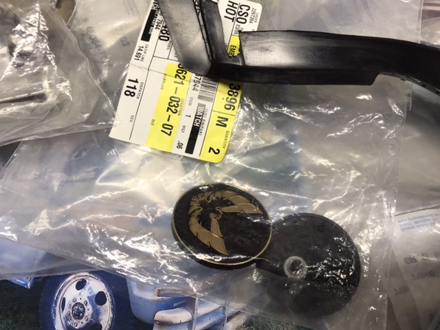

Lol, speaking F body, if you have power windows, there’s a hole in the door card, they put a emblem in there to cover the crank hole, The retainer is same as speaker box.

Here’s the emblem I’m talking about. Same retainer is used.

Burd , now I understand.
