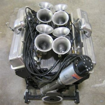

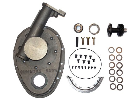

For my next major car project, I’ll be building the BMW 507 and I’ve been thinking of the power plant of choice. Aesthetically, the distributor needs to be at about the 10:30 position to mimic the original a BMW V8. I came across the Summers Brothers front distributor mount system and wondering if anyone has used this set up? Looks mainly like it’s a set up to make for eeasier blower clearance.
I’m wondering if the distributor is able to be clocked at any position based on the mounting holes of the cover? Using a SBC would make my running gear easy to assemble, but I want the asthetics to be as accurate as I can, and a distributor in that side of the engine would be BUENORIFFIC!!!

I think yes, although I have never used a Summers Bros set up.
I had two different RCD front drive set ups on my race car and both of those were adjustable to some degree. I can get a better pic later for you if you would like.

Sweet! Thanks for that pic, Damien. Yes, I’d like to see a closer pic.
I was thinking originally about that too, Lynn. But the 507s engine was equipped with two Zenith carburetors, and I’d like use a dual quad intake with carb adapters for a pair of Rochester 2Gs, and the distributor being clocked to the correct position would really complete the package. I’d be interested in chatting with you about the BMW V8 though. PM...coming in HOT!!!

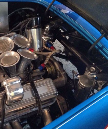

Looks like there could be come clearance issues with the water pump.

I would think along water pump would solve the clearance issues. I’ll probably call them and chat to get some answers!

Here's the engine from my Scarab race car with the Summers Brothers set up. I'm certain it is fixed in this position. There is a big spacer for the water pump and the pump is electric. I've had no issues with this set up.

Here's a good shot of the spacer and water pump.
