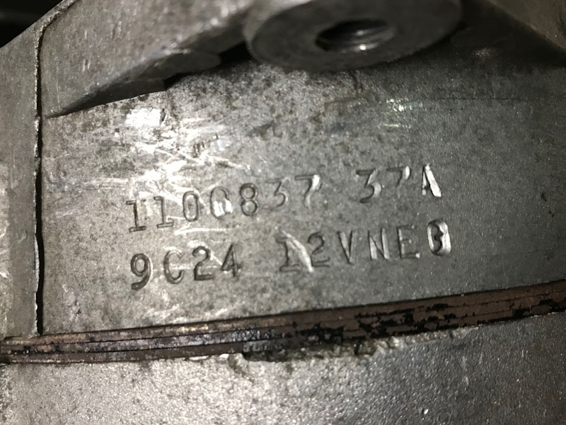

Hi Guys, I was looking for your thoughts/Opinions on this 1969 837 Alternator stamp. Does it look Legit?? Story told to me is it’s been off a 1969 Z28 since early 1980’s. It does look to me like it’s never been apart or rebuilt. Still having what I believe is it’s original finish. Thanks Rob

Looks fine to me. That date is seen on March & May Norwood cars.
Interesting...not April?

There probably were April dates; do not have a lot of data.
Have 2 N625xxx and 4 N642xxx-N645xxx VINs with 9C24 837 alternator.

X2 good stamp known date.

X3 good one.

Thank You very Much for the help guys !!!! ROB

So is that housing cracked?

that's not a crack, it is a step in the casting mold. Looks magnified in that close up.

That has not been messed with at all. Very nice stamp..
