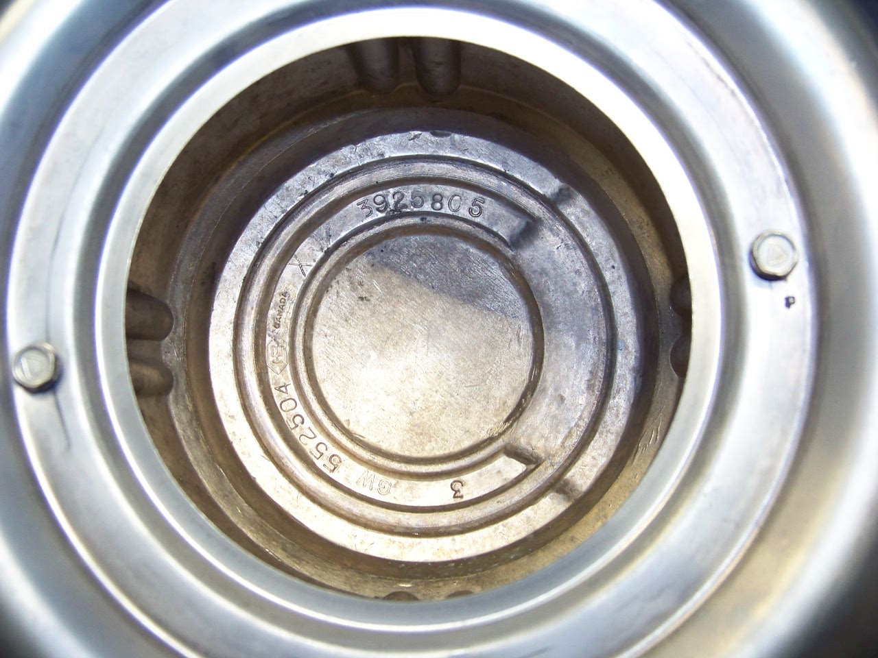

More photos -
FWIW of the sharpest most crisp caps NONE have a mark indicating they were manufactured in Canada.
Two have 2 flutes internally and one has a single flute, these 3 caps have the same internal structure other than the flutes with the part number and other numbers in the same font, same place, as well as the same recesses etc
The other cap was manufactured in Canada and has additional marks with a HB and recesses, it wax reported to have been purchased AFTER the car was wrecked in 1973.
FWIW The caps on my survivor 71 Corvette are all manufactured in Canada and have 2 flutes.
Who has a 68 Z with the original derby caps?
I would like to see what they look like inside...
