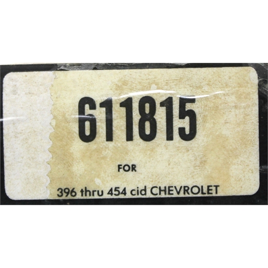

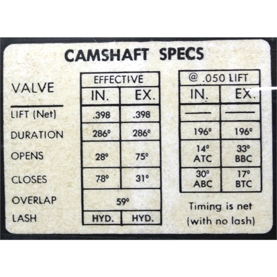

Hi folks,
Anyone have an application for Iskenderian 611815? Should be a BBC cam.
Thanks!
Attachments - The Supercar Registry isky bbc 611815_1.jpg isky bbc 611815.jpg

Isky

Thanks! A baby cam...wow.
