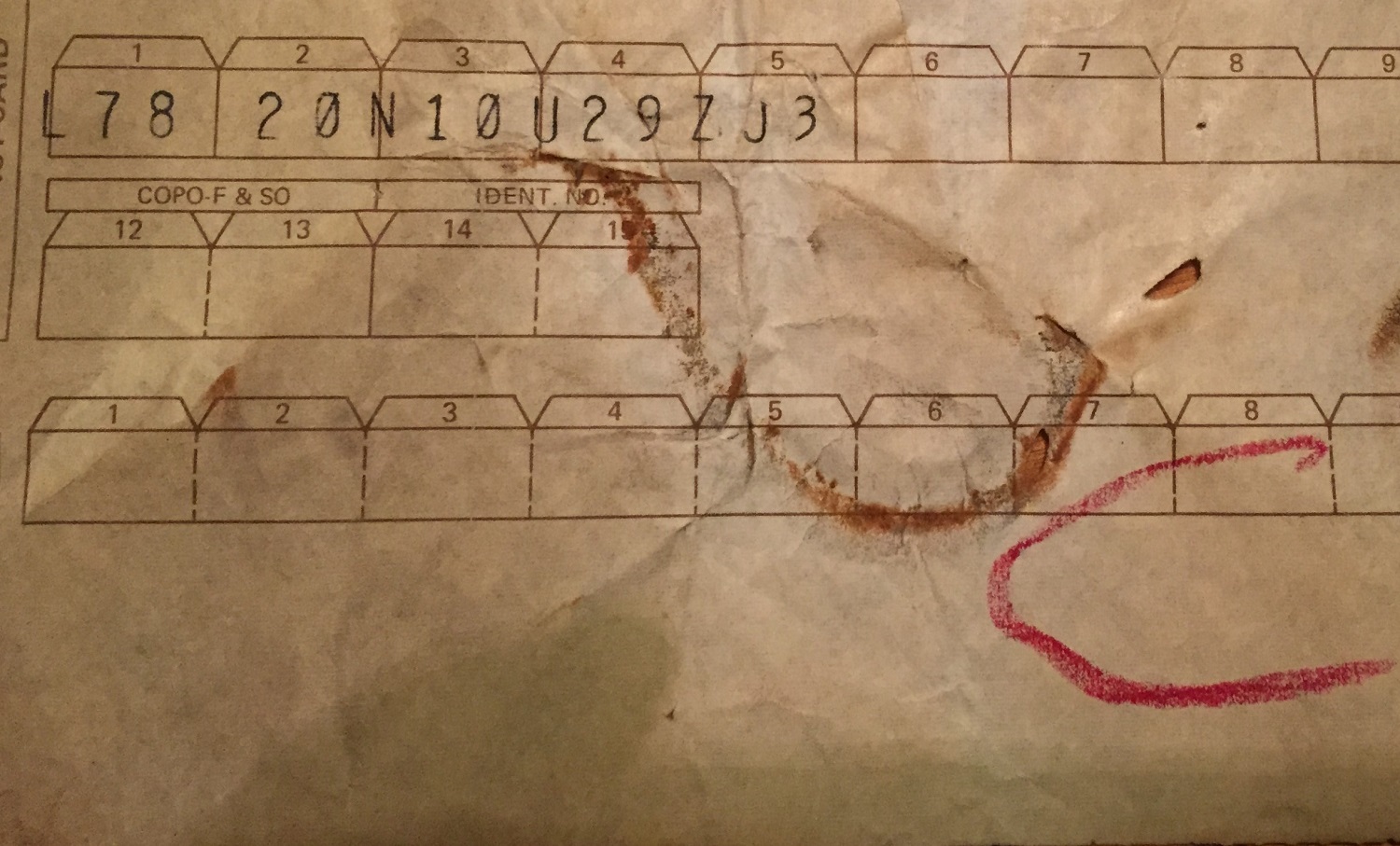

Follow up question...instead of starting another thread on my build sheet I thought I'd just continue this one. I decoded most of my build sheet but does anyone know what the 20 is after the L78 code in the first pic? And what does the 4 under the PP in the second pic represent?

Ed,
Box #2 was the trans code. Should read m20.
Looks like a typo with the letter missing

Hey Tony,
Thanks for the reply! It must have been a full typo as I have the original trans and its stamped P9S20B (with the VIN below it) which I believe is M21? Well at least I know what was supposed to be in that box

Originally Posted by Qtown Ed View Post
Hey Tony,
Ed
The buildsheet code 'M20'...does not indicate the specific transmission installed, eg; M20, M21 or M22...this code simply told the Fisher Body folks they needed to cut a hole in the floor for a manual trans. shifter. This is a very common point of confusion when folks look at the Fisher buildsheets. Basically the sheet indicated any work needed to the body to facilitate installing various options like; trim and moldings, floor shifters, consoles, decor packages, etc.
-wilma
