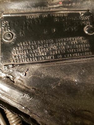

If the car is an L78, it should have an early design hood on it, which it does not. Also, why does the seller claim it’s the real deal, not a clone or tribute, yet lists no reason as to what he is basing that off. I’m sure if there was a build sheet, he would have mentioned it. A picture of the trim tag would be nice. Seller states cranberry red but pictures show black cherry.

Weak TT pic but looks undisturbed w/ 75/75 Cranberry Paint?

Too late to be a L78. Baltimore vin lines up with cowl tag build date of 06A. B D on the cowl tag makes me think a SS with stripes originally. If it were closer to me I would be taking a look.

When he added the pic of the trim tag to the listing, I also noticed the B D but all that means is that the car came with stripes. Most stripe cars were also optioned as Super Sports but there have been documented flat hood Malibus with the D88 option. Dale has a red 70 Malibu convertible on his registry with the D88 option on the build sheet and B D on the trim tag.

It's not a real factory 375HP Chevelle for many reasons.
