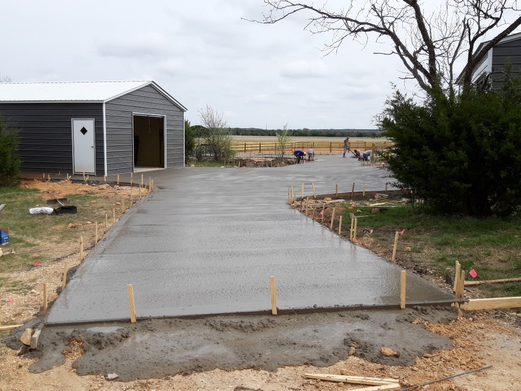

Not sure what happened to the starting of this thread by me, or why it now shows Dan "The Man" Vasic as the starter, but no matter. I'll just send him the bill for all of this!
Concrete on 1/2 of the 15,000 sq.ft. driveway which includes the shops and barn!! I just started framing the shops out for electrical. More to come....
Cheers
Dave
