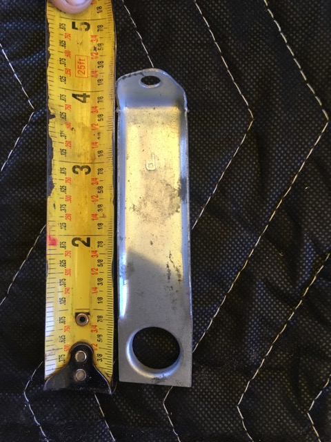

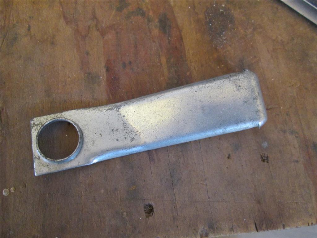

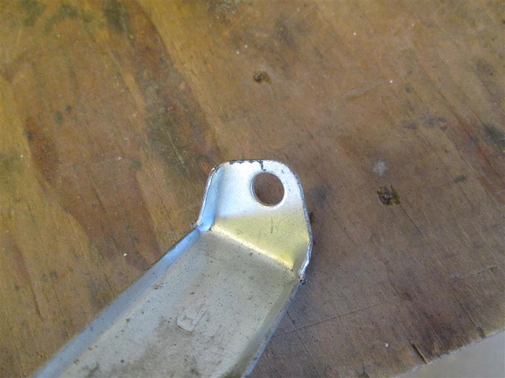

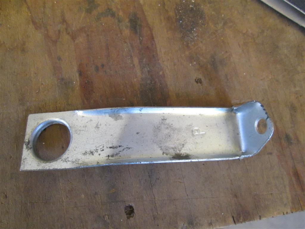

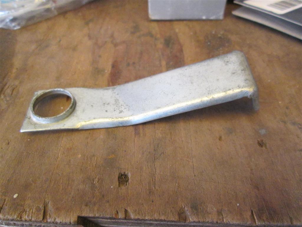

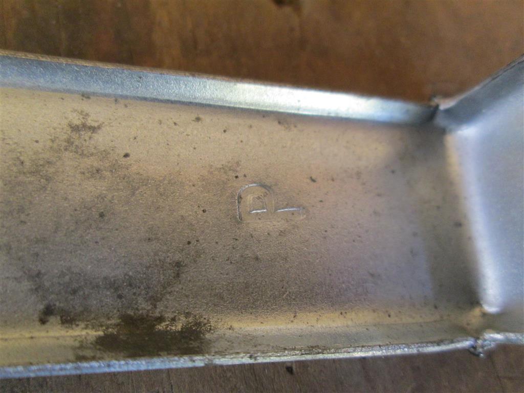

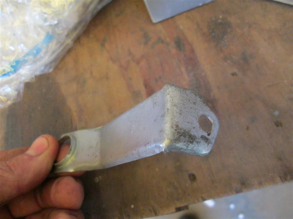

I'm wondering if anyone can tell me if this power brake hose support is an original part. It came to me with a bunch of other original pieces. All the ones I have seen are stamped "aac". This one is simply stamped with a "P". Has anyone seen a P stamped one before?
Thanks,
Jason

Looks right to me.

I have seen the"p" ones only in the service nos brake boosters assemblies. The black Bendix boosters kits especially. It's real just not assembly line stuff. Imho never seen just a p on a original car.

Just so I’m clear, are you saying this bracket came in GM service/accessory power brake kits and as far as you know the “P” stamped ones are post production?

Yes I've only seen them in Bendix brake booster accessory assemblies. I had a few nos Delco gold 9204 boosters and they had the AAC stamped bracket.

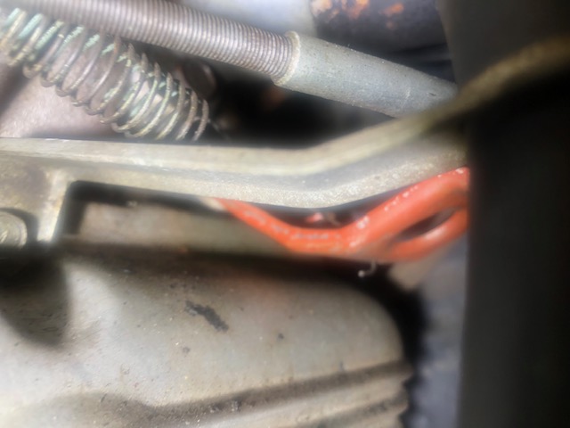

Here is the one on my 33K mile 69 Z.

What's the length on it? They made a shorter one for earlier Corvette.

This is what I typically see....

Sorry for the delay in reply. The bracket measure right at 3 3/4 inches from the top to the right angle bend.
