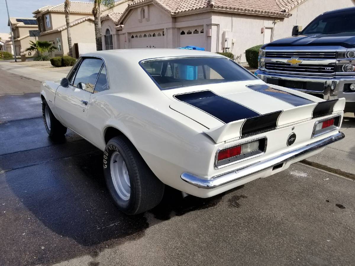

----This Z looks a bunch like a car we found in Ohio around Zanesville in 1977-78. The one we found was brought back to Classic Motors, cleaned up and sold fairly quickly. Can't remember another thing,,,LOL!...…..Bill S

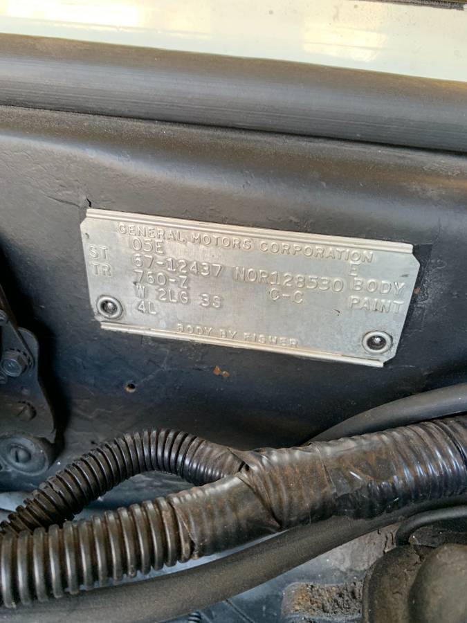

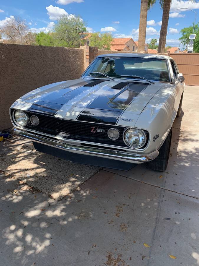

Fake tag...

Vin 124377N228746

Looking at those vin tag rivets, i’d Be double checking the hidden vin for sure!

Not my car or any affiliation just curious is it a fake vin tag, cowl tag, or both. Larry

Trim tag is 100% fake. Rivets on vin tag look to be replaced.

No photo showing the cowl plenum cut-out.
