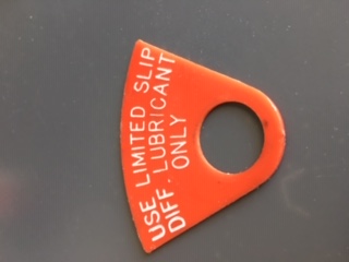

Just picked up this NOS piece, my question is when did GM change the wording from Posi to Limited slip? Also the hole size on this one is 13/16th.
Thanks

I believe this is when GM used the different variations of the red plastic tag.
66-69 = USE POSITRACTION DIFF LUBRICANT ONLY
70 on up = USE LIMITED SLIP DIFF LUBRICANT ONLY.
