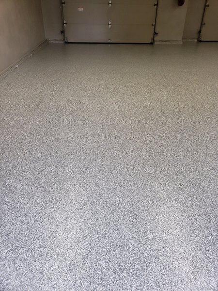

We did an clear epoxy coating over old concrete that was ground down before flooded with epoxy. It’s done well except for a few areas where it got chipped.
Completed floor.

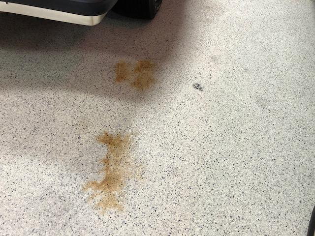

Just finishing a new garage and had the concrete polished. I would do it again. I have epoxy in one of my shops and what was supposed to be non staining etc is staining etc. Floor is actually dirty in these pics.

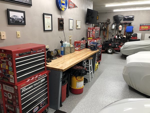

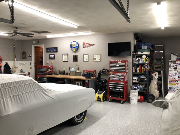

I work in the commercial construction business and chose to use a SikaFloor system based on recommendations from a vendor that I had 25 years of good experience with. It is a 3 step, seeded system. First day they come and grind the floor and install the base color and chips, second day an initial clear coat and more chips, 3rd day a final gloss clear coat.
Not inexpensive for sure, but very happy with the results and performance. I did not want to mess with the home store do it yourself kits that start to fail after 10 years or so. Very impact resistant with floor jacks, jackstands, dropped impact sockets (just used them last night), highly resistant to everything I have put on it so far (melting salt water from cars, oil, grease, gasoline, mineral spirits, etc.)
