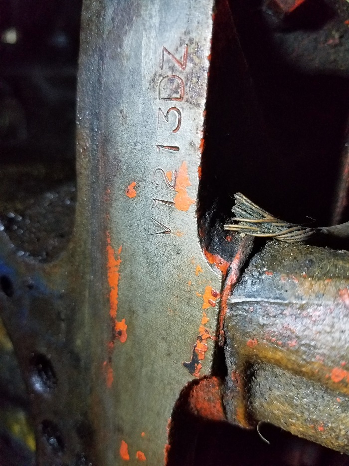

What do the experts think?? I feel it real and no issues......Dave

Dave, no expert as you know me, but it looks legit to me as well!

Is this the one from Craigslist yesterday?

Shouldnt the VIN be visible with this much pad showing unless maybe a LA car?

broach marks are good. stamp looks as if done with gang, if it was faked they are pros.

The deck has a nice original patina. I think it looks legit.

I think it is real.

That one is legit.
Nope, Norwood car it's down by the oil filter

I think its real too but seems a bit early for vin by the filter, CRG does say december sometime so it must be one of the early ones
