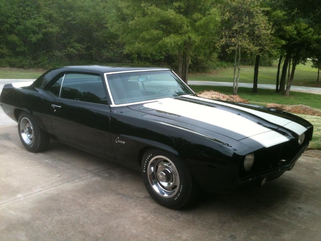

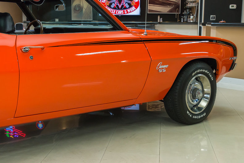

Has anyone ever had G70x15's on a 1969 Camaro, preferably on factory Rallye Wheels? If so, any tire rub problems? Does anyone have a pic of a 1969 Camaro with G70x15's? I thought for sure one would pop up on a generic Google search, but no luck there either.
Kicking around the idea of the new FR70x15 Firestone radial redlines, just curious if anyone has ever had G70x15's on a 69 Camaro or if F70x15's are as big as the wheelwells will handle.
Edit : Metric equivalent of G70x15 is P225/70R15, so if anyone has run this size on a 69 Camaro, factory 15x7 Rallye rims, please chime in.
