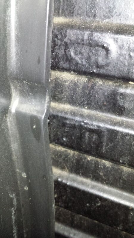

Here is a Harrison rad it seems to show C F with a small D between the C F …. Can anyone help ID this rad?

The small D is for the month April

That tank was used from 68-71 in lots of GM products, Nova to Cutlass.
The core is what may ID the rad.
